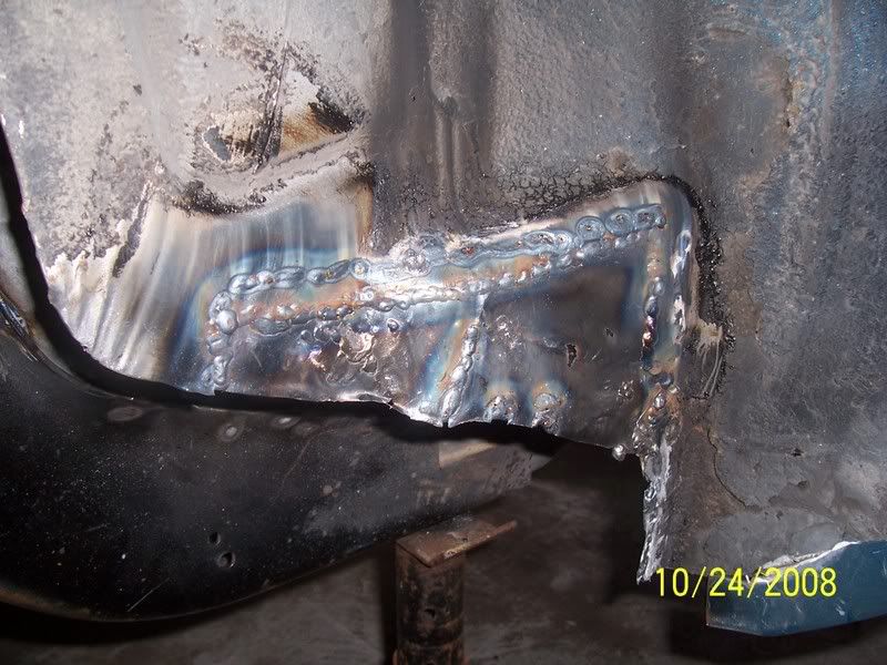

Worked on the passenger side over the last couple days. I had a professional welder come in and do the driver's side but I figured I'd tackle the passenger side. Now I'm second guessing myself. I ground my welds down and there is no sign of a seam. Does this mean the weld is good? Here's some pics...

Thanks Guy. I have a doner pan that I am going to use...just like I did on the other side. This pan is not as good as the other so I will try to leave more original floor. Actually, I have already removed most of what I plan on removing. What are your thoughts on grinding down the welds? Do you feel it weakens the weld at all?

As long as ya grind flat and not grind into the weld it should not weaken it. If your read my project thread, I grind all my welds flat, well the ones I can get at anyway. lol

Old 10-24-2008, 07:55:17 PM   #30
volsfan
volsfan's Avatar
Location: daytona beach, fl
Posts: 2,053
Todays contribution
Got most of the passenger side done today. My donor panel had some rust issues so the missing metal you see will have to be fabbed. Anyway, it rained here today so I spent the whole day on the car...
Before...
After...
