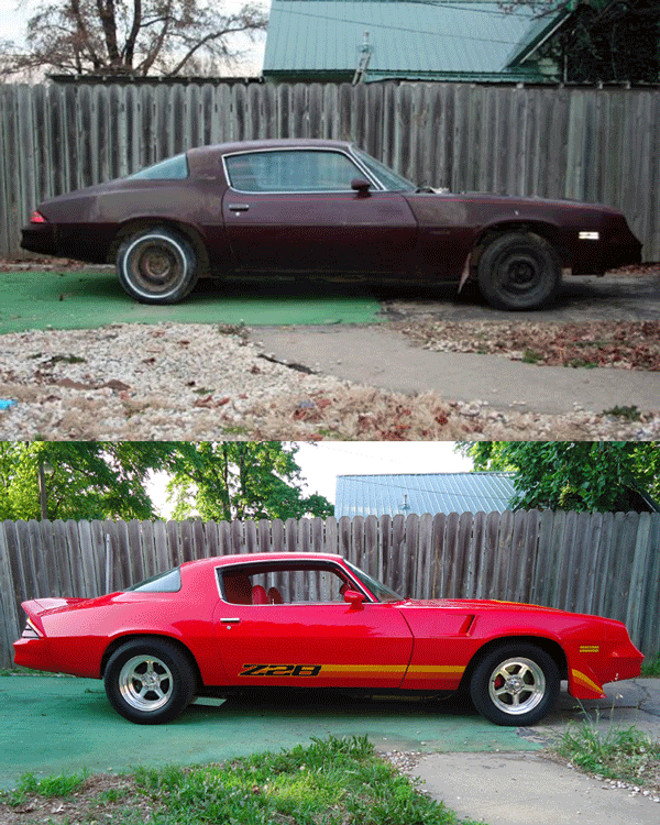

Originally Posted by Blu-By-U 79Z
Well unfortunately i dont have any progress to show... its been just too cold lately. BUT the weather should start getting a tad better allowing for me to get more work done. I was toying with the idea of a cowl hood but i believe i have talked myself out of it. Here lately i have been looking into wheels just to see if there were any styles that caught my eye. I like the billet Specialties streetlites. I have seen em on a few cars but not my color so i did a quick photoshop. Opinions?
you may be able to do a color photoshop on my car.. i have them wheels and LOVE them.. but this spring i am putting them on my chevelle and putting pro stars back on the camaro.. (because of wieght)

Originally Posted by falloutboy
Holy cow??
and now where is the Photoshop?? I see your car finished with some nice wheels.
Lol I wish man. Slowly but surely I'll get there.
Dio,
Actually those are your wheels LOL the middle picture of ur car finished. I took the wheels and size them on the blue z.
Dio,
ohh i see it now! thief!!! hahaha looks great!
btw those are on a worn stock suspension
15x10 5.5 bs 295/50-15
15x3.5 165/80-15
ohh they take special lug nuts.. keep that in mind when you order
