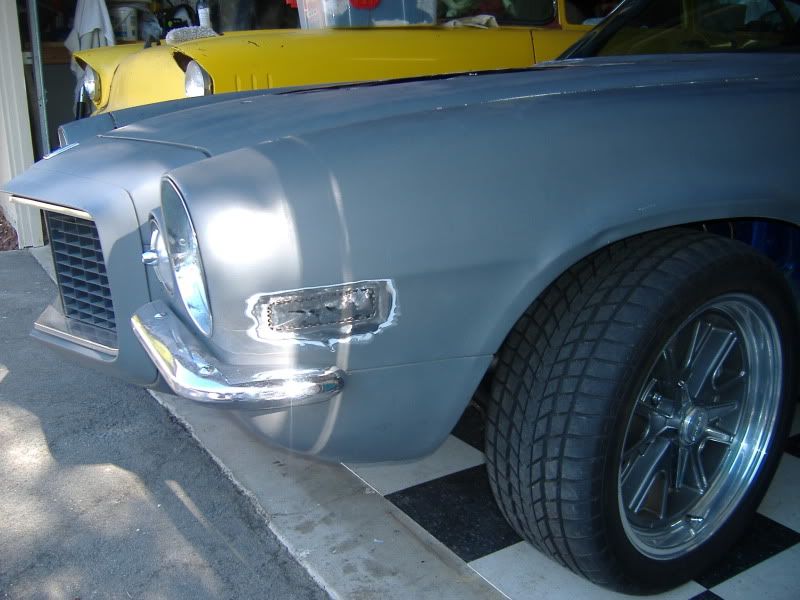

I took care of the holes and gaps this weekend.
I also filled in the front and rear marker light holes.

I do love that blue... it was the planned color for my car since I was 16.
But... then I saw the copper-orange color on the new Dodges... and I'll be sanding off the blue.
Kind of a pain though.. cause I matched the gauge cluster and a few other items to that blue...

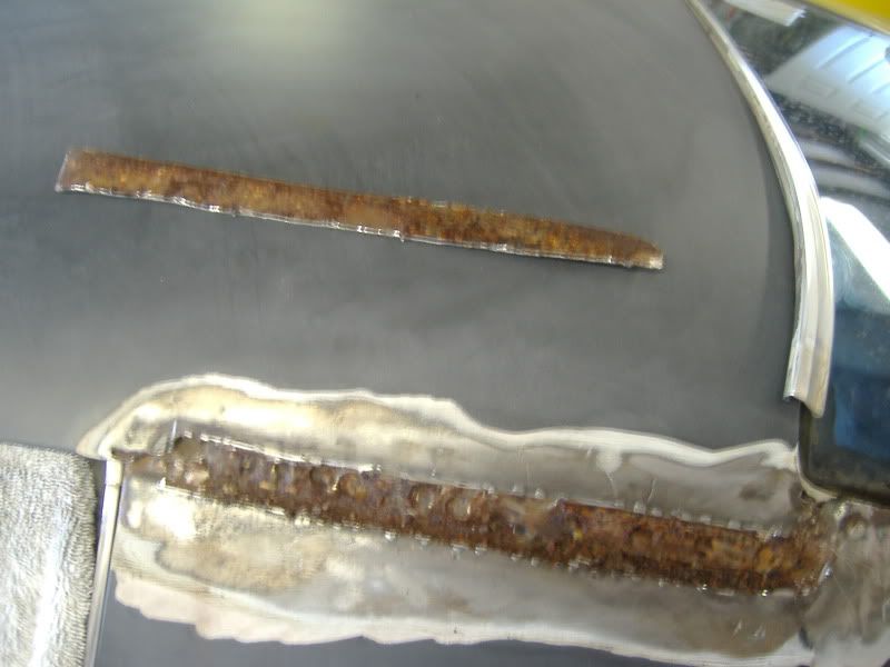

Ok... got a little more done today too.
My lower drivers side windshield A-frame had some bubbling rust issues.
My fix 13 years ago was cleaning it out, rustproofing the spot, then filling it with fiberglass, etc.
Didn't work. Well, not when the car sat outside for 6+ years without paint on it..
So, I cut that out and welded a patch in. This time I'm taking every precaution I can... weldable zinc-primer underside, Rust Mort, etc.
Welded and ground flat.
From there, I moved back to the B-pillar. 13 years ago, I had substantial cracks, etc. Found out after buzzing everything down that the quarter had been replaced sometime in the 70s, but it was a botched job, and wasn't even welded. It was brazed on.
My idea then was to fishplate a thick piece of 16 gauge steel.
My idea didn't work too well.
Left me with bubbling rust yet again, and more cracks as seen:
Here you can see the plate I welded in.
...And here's WHY the rust bubbled up the primer a bit.. Somehow water must be getting behind the plate... as it was VERY rusty once cut out.

I was surprised just how much filler was there. I guess I forgot how thick it was over the years.
I'm not happy about that.
Happiness aside... I'm debating re-replacing the whole quarter.
I replaced the lower 'skin' 13 years back, because the full size quarter wasn't in production.
If money wasn't so tight, the new quarter would be in transit... but it's hard to burn $400 right now.
The roof-to-quarter seam is one problem area.
What you can't see is that there's a reason that filler is so thick. It appears the quarter's top is a tad too far in. Something's not right there.
The rear area surrounding the taillight panel is another.
Time and filler can fix anything... but I'm not sure all that work to repair the shoddy repair is worthwhile.
Gotta make a decision here... to spend... or not to spend...
