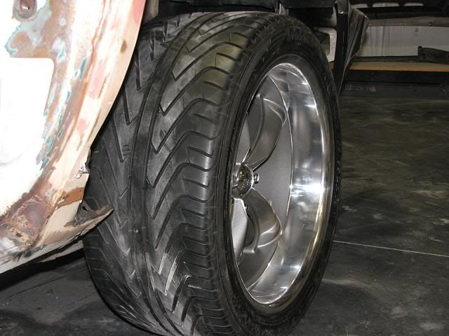

Tire update..
Ok heres a few pics with the Michellin Sport tires on:
Rear's 285/35/18
Front's 255/35/18
I like the look alot better especially the rear....the goal is slam the car at least 2"-3"

Wheels and tires look sharp... Your trunk pan turned out real nice, how bad was it to put in? Did you get the donor yet? What parts do you need off of the donor chevy? Keep up the good work... one day at a time... There will be light at the end of the tunnel some day lol... Rob

wheels look awesome with the new tires. i have the same wheels and am debating about putting 295's on the rear. do you think they will rub with the car being slammed? my camaro is currently on ptfb comp gt springs...keep up the great work!
