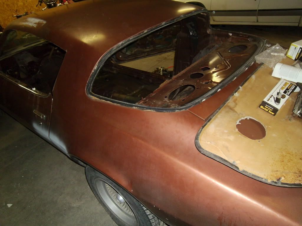

hello,i bought a 78 z28 with a 4 speed,so i joined.i took it home 12th of december 2011.
i wasnt completley sold on the second gen untill now.i love this car.never restored/built a car yet.i have done a few bikes,and guns.always wanted to,but just never did it.now im older a little more paitiant.so far i have removed the front clip,replaced the door hinge bushings.cut the right floor pan out,and removed all interier,back glass,tail lights.i bought a full passenger floor pan from ebay.going to fit great aftrt notching it in two places.just found a good local dash pad,saved some expected to spend money.i need to find a few more items,sand,prep and paint.going to modify the motor a little.designed a version of the del-alum bushings that i will make myself,already made a couple sets of solid subframe bushings.im still have not decided what color.

bam!!!! new floor pan.couple of spots look like turky crap.but it turned out better than i thought.thin sheet metal.felt like cutting so much out was a bad idea,untill i set the pan in.them felt much better about it.

Floor looks good I had to do both sides on mine.
