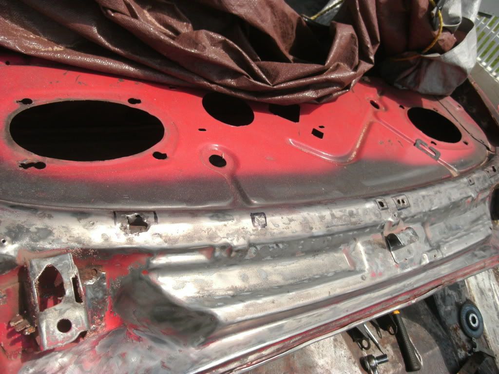

More updates.
Find some rust at top of the trunk.
Fixed.
I finished the trunk, it needs to be cleaned and primed, maybe next week.

Drivers side rocker panel
I was working with the drivers side rocker panel, it was very rusty, so I removed all rust and weld a rocker panel skin and I like the final results.
Now I am installing the doors, fenders and hood to set all the gaps before I weld the quarter panels, I'm struggling with the hood a little because it sits higher than the fender when it's close, I'll post pics of this later.

Some progress...
I've been trying to put the car together, but to be honest, to make does gaps look correct is a PITA. After I installed all doors and fenders I noticed that the passenger door was a little off from the rocker panel, so I took the fender out and fixed the problem, then when I bolted the fender I noticed that the gaps (fender to door) at top was correct and at bottom too, but the fender body line, was like 1/8" out. After almost a day taking the fender in and out, adding shims forcing the fender to fit, I got the same results. I was about to surrender when I thought that It would be a good idea to make a small cut in the inner structure of the fender and spread it a little, I did it and "voila" it fits perfect. Here are some pic of what I have done so far.
Now I'm working with the driver's side quarter skin, I hope finish this soon.
