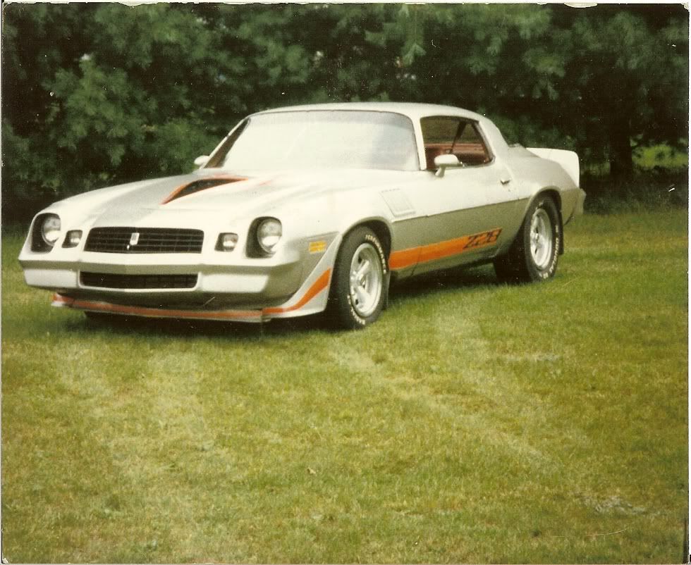

The car in 2000 when i purchased it. (notice the fender crushed behind the front tire)

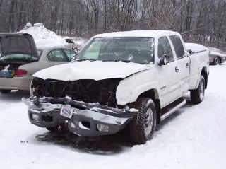

In January 2009 I had a guy slide through an intersection on ice and t-bone me, then push me head on into a tree in my 03 1500HD silverado with a 6.0 and totaled it. (this is where the LSX swap comes into play)

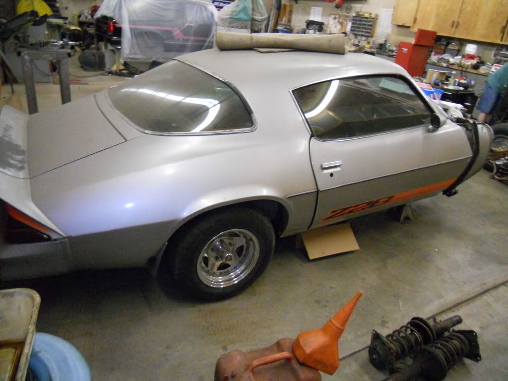

Here are a few more pics of the car. This is still factory paint.
