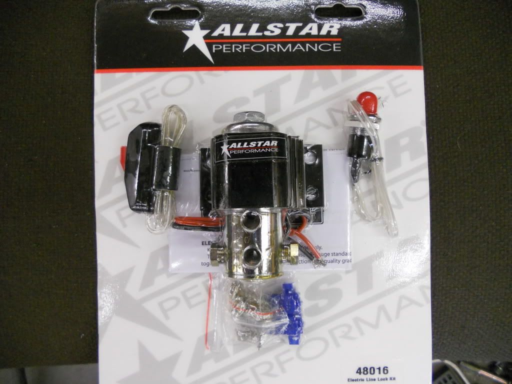

Here are a few pictures:
Rear of the car looking forward:
Looking towards the back:
Line lock:

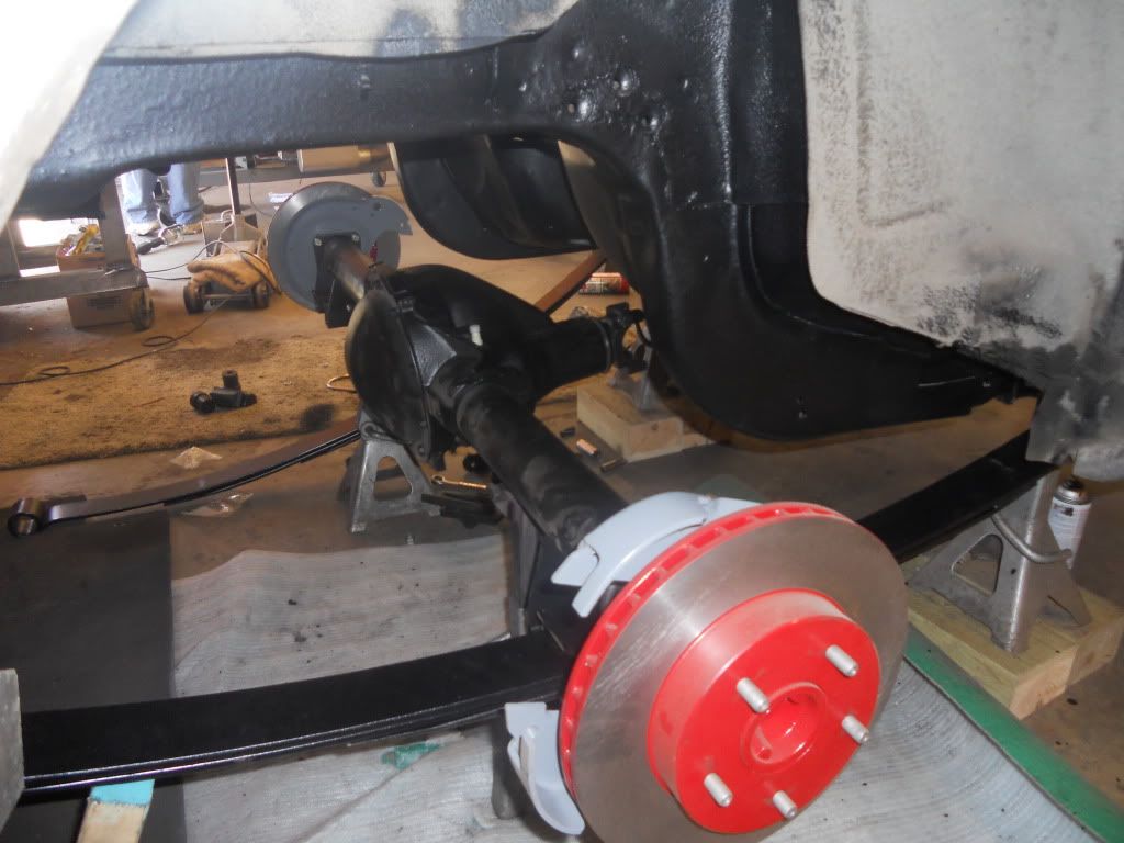

Got the rear end installed, and that is about it:

what disc brake conversion are you using? looking into something similar myself
It is actually a stock rear end out of a 79-81 trans am. You could get it as an option in those years. I found it on Craigslist with an almost new posi, and brand new 3.90 Richmond gears for $450! I pulled it all apart before sandblasting, just to make sure everything was set right.
