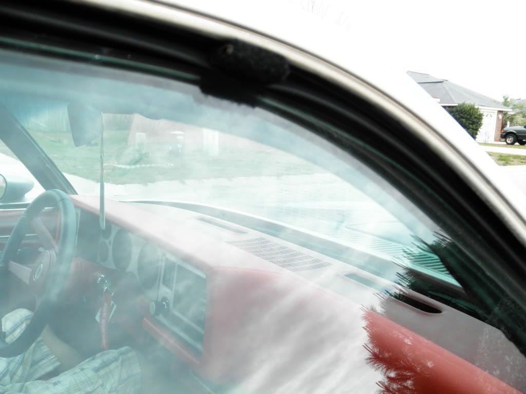

Finished installing the weatherstripping and inner/outer window seals on the passenger side. The glass seals up pretty well, but not 100%. The glass is adjusted up as far as it will go without hitting the roof and as far forward as it can go without hitting the A pillar, but it still doesn't contact the seal tight enough at the radius where the A pillar transitions into the roof. Aggravating, but it's as good as I can get it, so time to move onto the driver's side.
B pillar area:
B pillar close-up:
A pillar area down near the mirror:
Radius area:

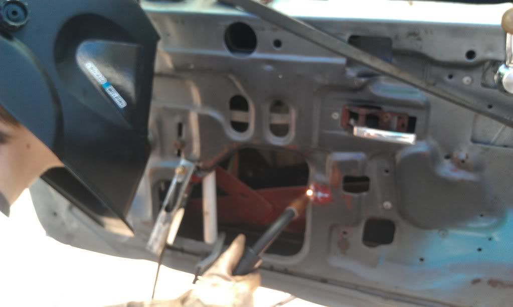

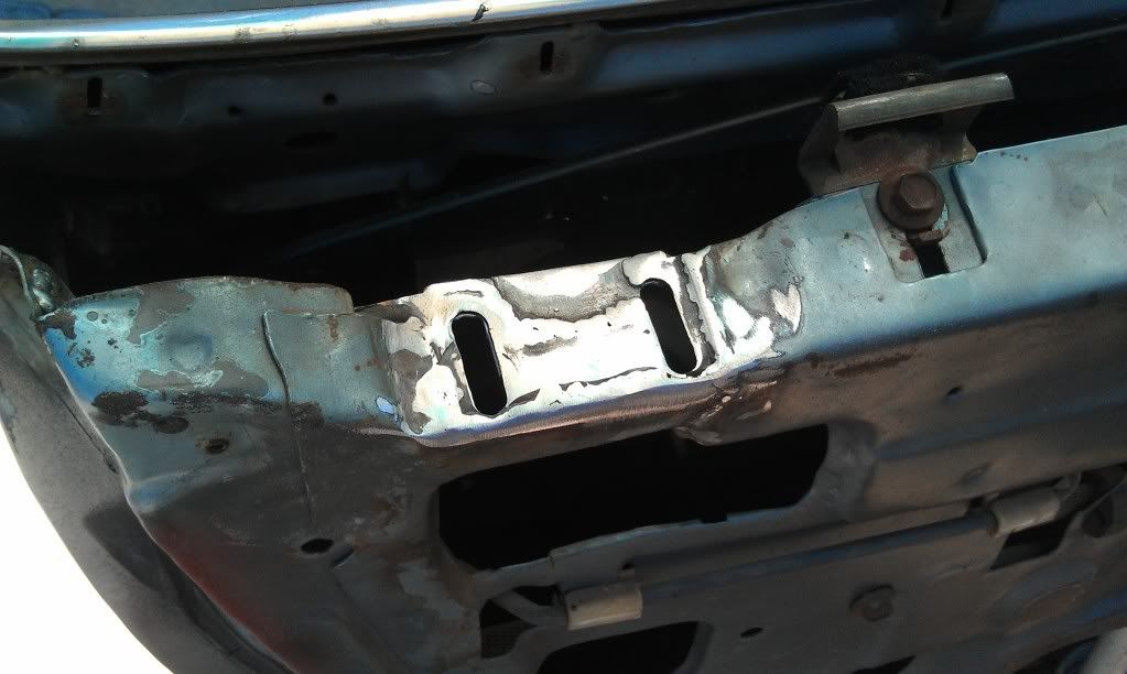

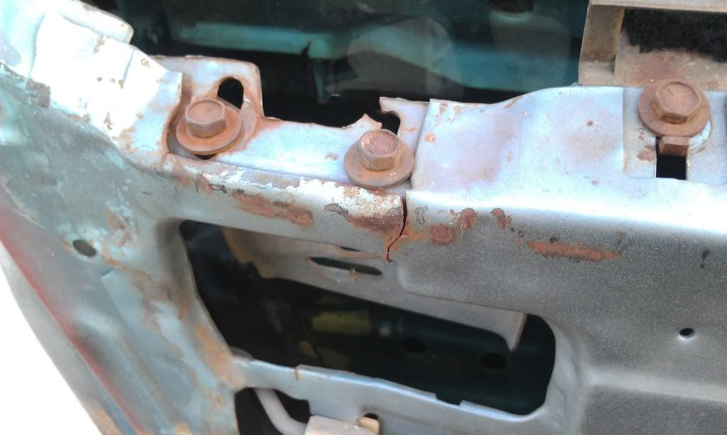

Moved on over to the drivers side door and found out why it had been rattling this whole time. The inner panel was cracked and the section that holds the top of the window channel bracket was broken and separated from the inner panel, which allowed the whole assembly to flex. The bracket at the bottom was also broken and let the glass bang back and forth when the door was being shut. I don't know how stuff like this gets broken.....if this car could talk, I'm sure it would have some stories to tell.
Perfect opportunity to teach junior a little welding. I got him started out on some practice plate and then moved him on over to the door where he tacked the patch in place and worked on the crack on the lower part of the door.
I finished up the welding and here is the repaired part with the slots restored for adjusting the bracket.
