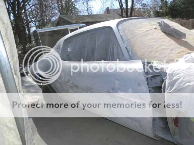

Well she's all one color now! Primer gray.

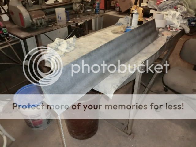

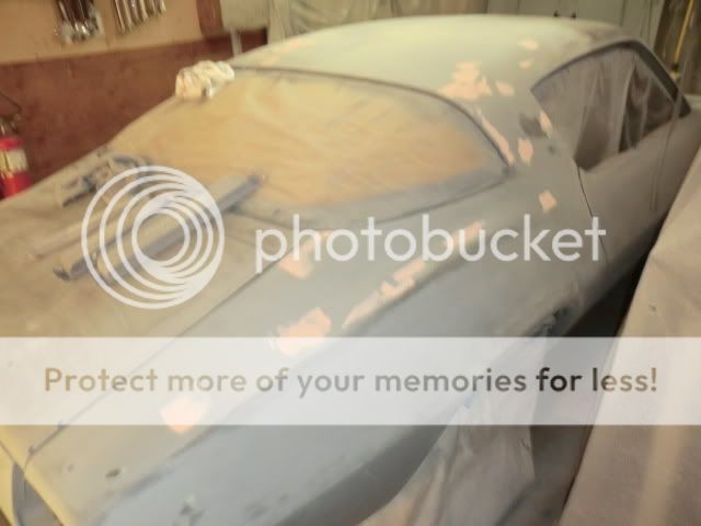

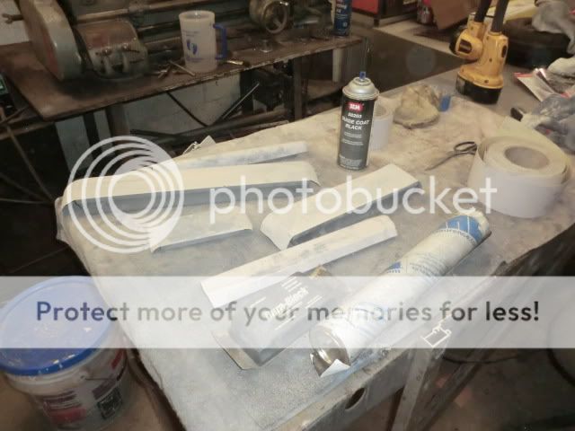

My new best friends
Hit with guide coat
Aftre the first round of blocking, I did the areas I suspeted of needing work. Not too bad

Block sanding takes forever it seems..
what primer are you spraying ?
are you going to spray the color yourself too ?

It is 2k high build primer. Blocking isn't bad, I removed all the black paint by hand. That was forever!! I may spray the base coat, I will not spray the clear here. I can't keep it clean enough. The base I can wet sand.
I'm keeping the trim and bumpers black. The only chrome I'll have are lug nuts and centercaps! I'm thinking brite red with black stripes for paint. I'm going to do the wheelwells and rad support body color also.

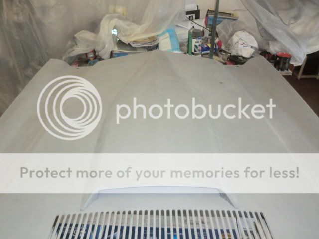

She's out in the sun
Thinking carbon fiber on the scoop with a carbon fiber stripe down the center of the trunk. It'll have the 1/4" pinstripes
Just about ready for 2nd coat of prime and final block.

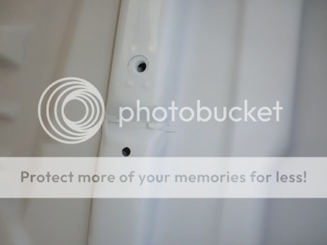

Heads up to all using factory hoods. I would not have noticed this if I hadn't been sanding. The factory has "fold areas" or "crumple zones" right in front of the hinges. They were very cracked!! I think the hood would have folded if I hadn't caught this. I left extra weld on there to be safe!!
