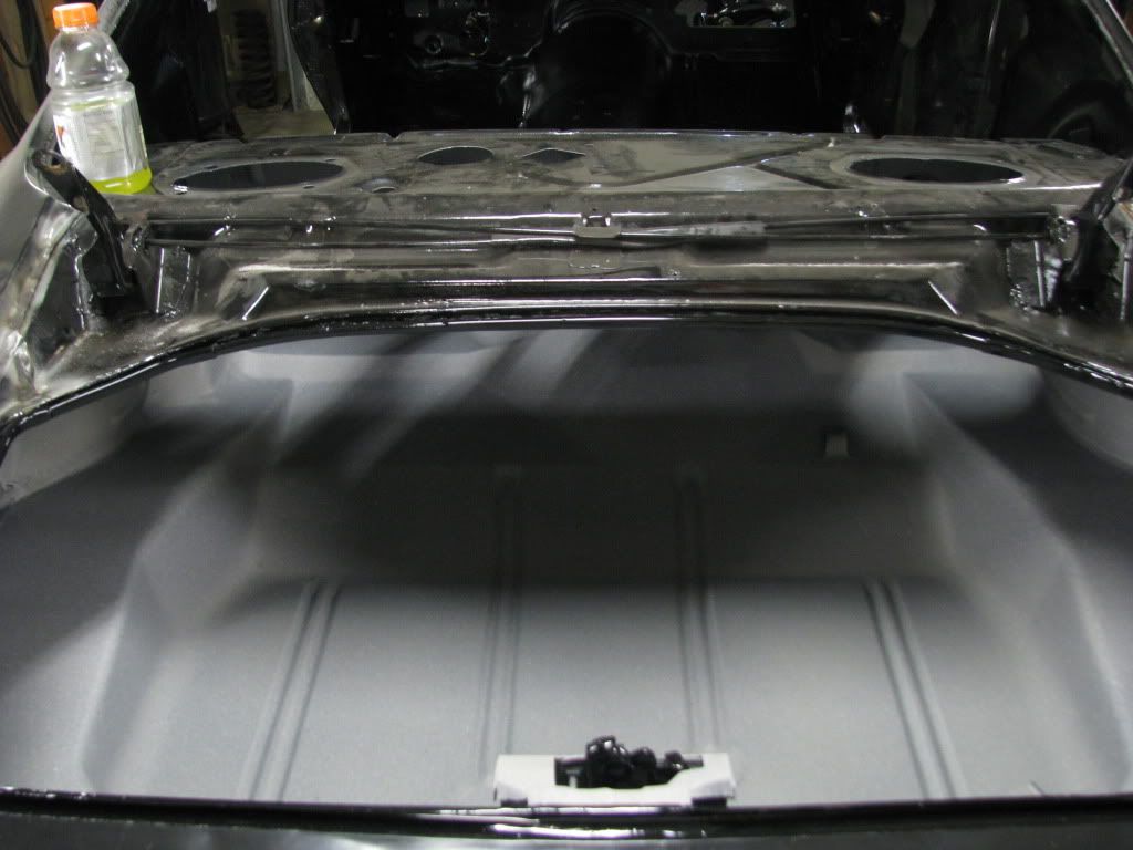

I also had a hard time finding a replacement weatherstrip lip inside the trunk, so again I purchased one for a 1st gen and modified it. After a few hours with a die grinder and welder, it came out pretty good. Then, finally some finish work, epoxy and splatter paint in the trunk.

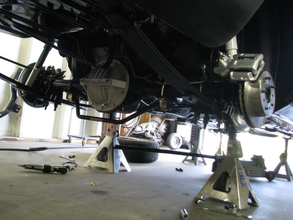

I then turned my focus to the rear end. I built a 3.73 posi and converted to SSBC discs. I added the Trick Flow diff cover th strengthed the 10 bolt as much as possible.

This basically brings the project up to date. 2 days ago, I finished the brakes and dropped it on the ground for the first time in a year and a half. It is a rolling chassis!

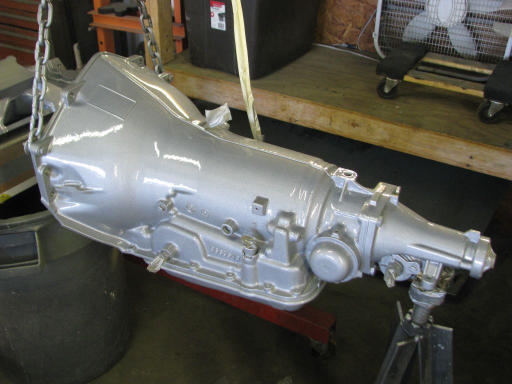

Also got the 700R4 back from the transmission shop and treated it to a paint job as well. It's built with the heavy duty sprag, eagle clutches and a whole bunch of other stuff to make it survive behind the 421. It's wired so the torque converter only locks up in overdrive. Special thanks to Jimmy and Larry at Citrus Transmission in Homosassa FL.
