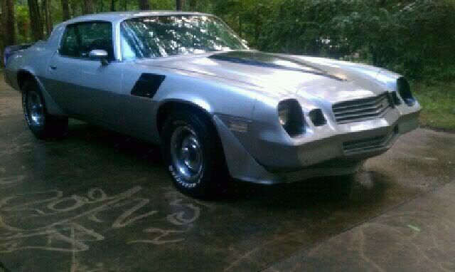

This should be a link to a few pictures.
http://s1271.photobucket.com/albums/jj634/z28n00b/

I'm headed out the door for work... so I won't be much help tonight, but the guys here are great knowledge resource about our cars...
car looks pretty good to me.. get busy and get it passed inspection!
