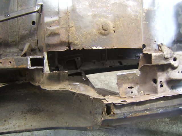

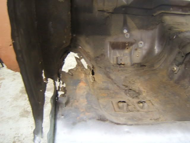

    3 months after we moved finally got the garage in good enough shape so I can heat it in the winter. So now I can get back to work on my toy. It is a 1974 Z28 4spd car. I bought it complete minus engine and trans. I think $1000.00 was a good price with all the new parts someone had put on her. Brakes all the way around, all suspension front and back. front fenders and inner fenders are all new. Maybe they gave up when they saw the left rear frame rail, who knows. She will get new rocker panels, right OEM full quarter panel, inner wheelhouse, trunk flor, trunk drop off, rear tail light panel, rear finish panel and I got a left OEM used full quarter panel and both rear frame rails from a Calif car. I am planning on working on that LH rear frame rail this weekend. I will post updated pics as things go together. Here are some pics, see what ya all think?

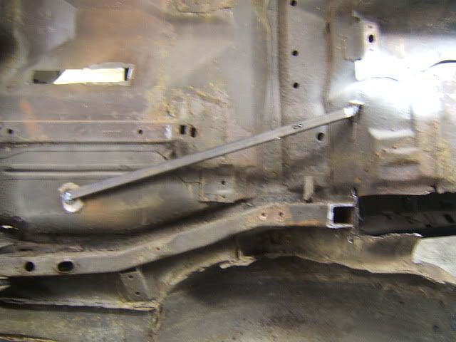

    Did you repair the floor board? If so it looks like you are off to a good start and have the skills to get-r-done. Man I thought my frame rails and torque arms were bad??? Were the springs holding up the back seats LOL? If it were not a Z I would say go ahead and back halve the car...so much easier. But it can be done. Tack weld some pieces of bar or angle iron at several points along both sides of the rails and take some pics and measurements so you can be sure to get the replacements in the same locations. And make sure to only remove one at a time. Also, if they make the true full tunk pan for that year I would pay extra for that as the patch was a pain on my 71...they did not have the full one available when I did mine.

    I did get a full oversize trunk pan but probably wont use the whole thing. I am going to change only front piece and rear piece of frame rails, not going to change complete frame rails.
