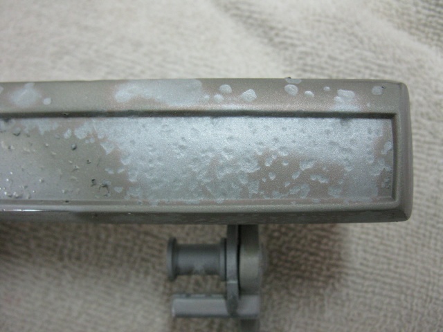

I mentioned yesterday That the Parts place is reproducing the colored inserts (Yellow), but i saw other colors too. So, in case you are restoring your original door handles you can get these inserts.
I couldn't find any light copper inserts for my car during resto, so we decided on paint and clear instead. Just another option to consider.

I have bought NOS GM inserts before for my 74 handles , they came in a flat white primer ready to paint as needed. They worked out perfect .

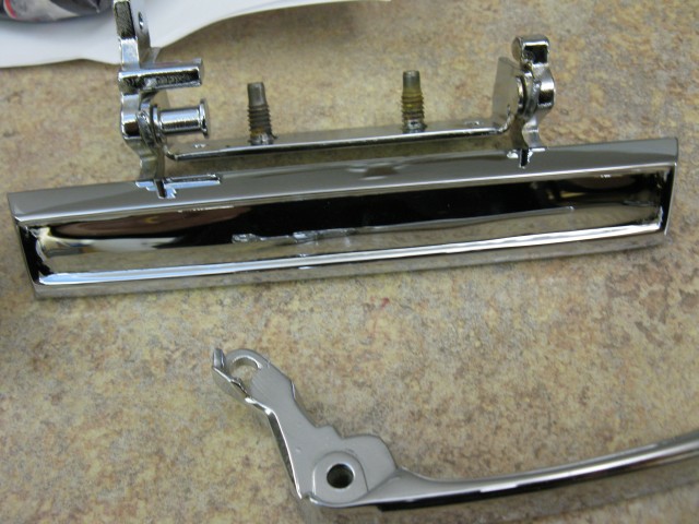

I know this was discussed last year, but I just want to clear something up. I have had for several years a pair of OER door handles. Members are saying that the reproduction door handles and even the later GM OEM handles do not fit into one of the holes in the door skin. I am sure it is the side that has the larger arm with the spring. I measured the length of the rivet that goes thru the spring and is riveted on one side, it is exactly one inch long. So does that mean that the original bolt or rivet was 15/16 inches long and would fit. If anybody has a used or NOS door handle, could you measure it.
Thanks John.
I am the original owner of a 1973 LT RS. My camaro does have the original doors. When I went to replace the door handles I found that the repo handles were not the right size. They only fit the repo doors. I was able to track down an original pair but looking through my paperwork I can't find where I purchased them from. Sorry.

Thank you for that extra information. Wow you have to grind down two things to fit. I remember a couple of members said they used reproduction door handles and had no problem either they were lucky or had repro door skins. This was last year. Earlier today I came across a site that reproduces the colored insert for the handle, but the only color was yellow. How many Camaros had yellow exterior color, not many I would guess.

I had trouble with the OER handles not fitting. I sent out my originals, nasty as could be, and they came back perfect.
It was money well spent, and they fit like stock! ;)
