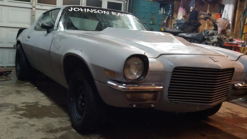

So I picked up this 77 LT Camaro as a roller in November 2013. It has a 1970 front end and the original 77 tail. It came with lots of new parts and is relatively rust free for my area (Northeast).
My Plan is to restore/mod it into a 1970 Baldwin Motion tribute/clone. I know some here may scoff at such a thing but too bad. There arent many 2nd gen Camaros around in my area so this one should really stand out.

I pulled the car into the shop about 3 weeks ago and already started in on the fun.
Here is my plan of attack for the shell:
-Strip car down to the shell
-Find the rust
-Cut out the rust and weld in new steel
-Replace the rockers (they are dented badly)
-Rebuild door hinges
-Re-skin doors
-Hang and align doors to rockers and existing rear quarters
-Cut off rear quarters
-Cut off trunk drop offs
-Cut off tail panel and inner crossrail.
-Hang new trunk dropoffs
-Hang new quarters
-Hang new inner crossrail and tail panel
-Fabricate trunk extension to extend from 77 trunk to 70 tail panel
-Put the new solid shell on the rotissarie for next stage.
