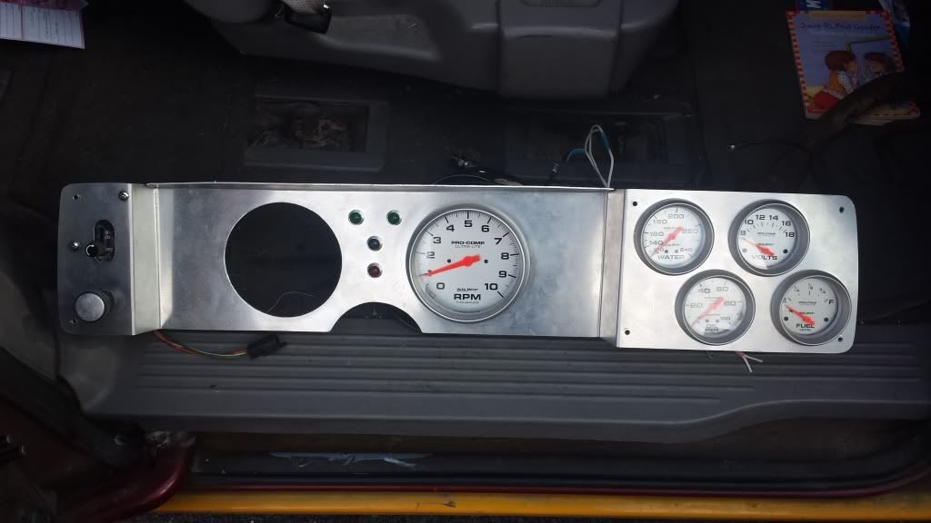

I took my stock dash to a buddy with a brake & had him duplicate the bends in a piece of 1/8" aluminum.

protour73 said:
Fabricated my own design, for my '73
That is a sweet looking dash, I like what you did with the gauges. In my 79 I moved my 4 gauges over to where the center a/c vents were, I just didn't like how I couldn't really see the gauges behind the steering wheel. Of course it looks better in the car and with a speedo, I'm waiting for my new electric speedo to come in.
