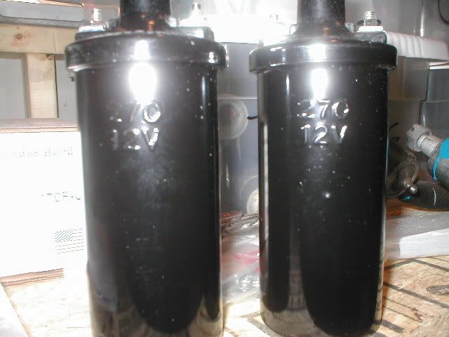

Here is an addtion to what has been said. Here are two "202" coils.
The one on the right is NOS. Each has under the "202" embosed "12V" I also have some "270" coils with the "12V" instead of "BR"
