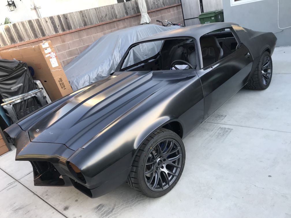

WOW!.........the panel gaps, the prep work, attention to detail..........awesome!!!!! Love the wheels!
Thanks! The gaps still need work. Pics are intentionally from a distance...

I pulled the front back apart and backsprayed with Summit epoxy primer and matte black urethane. Prepped and sprayed the dash/cowl and rear window lower "trim" the same too.
I put everything back together in prep for body shop shopping.
