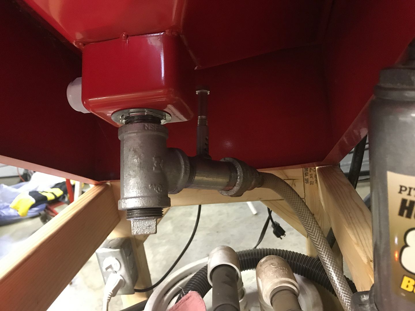

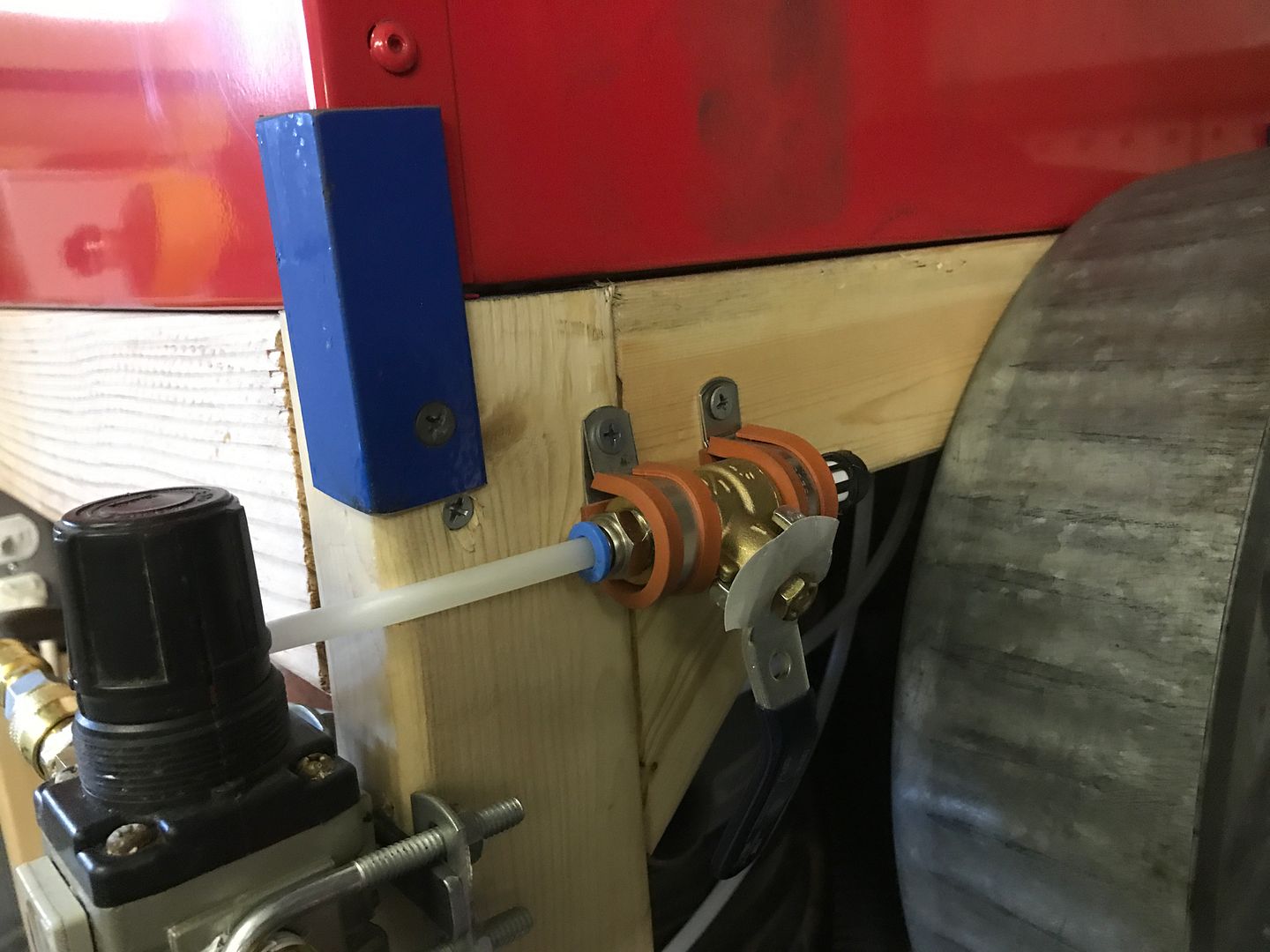

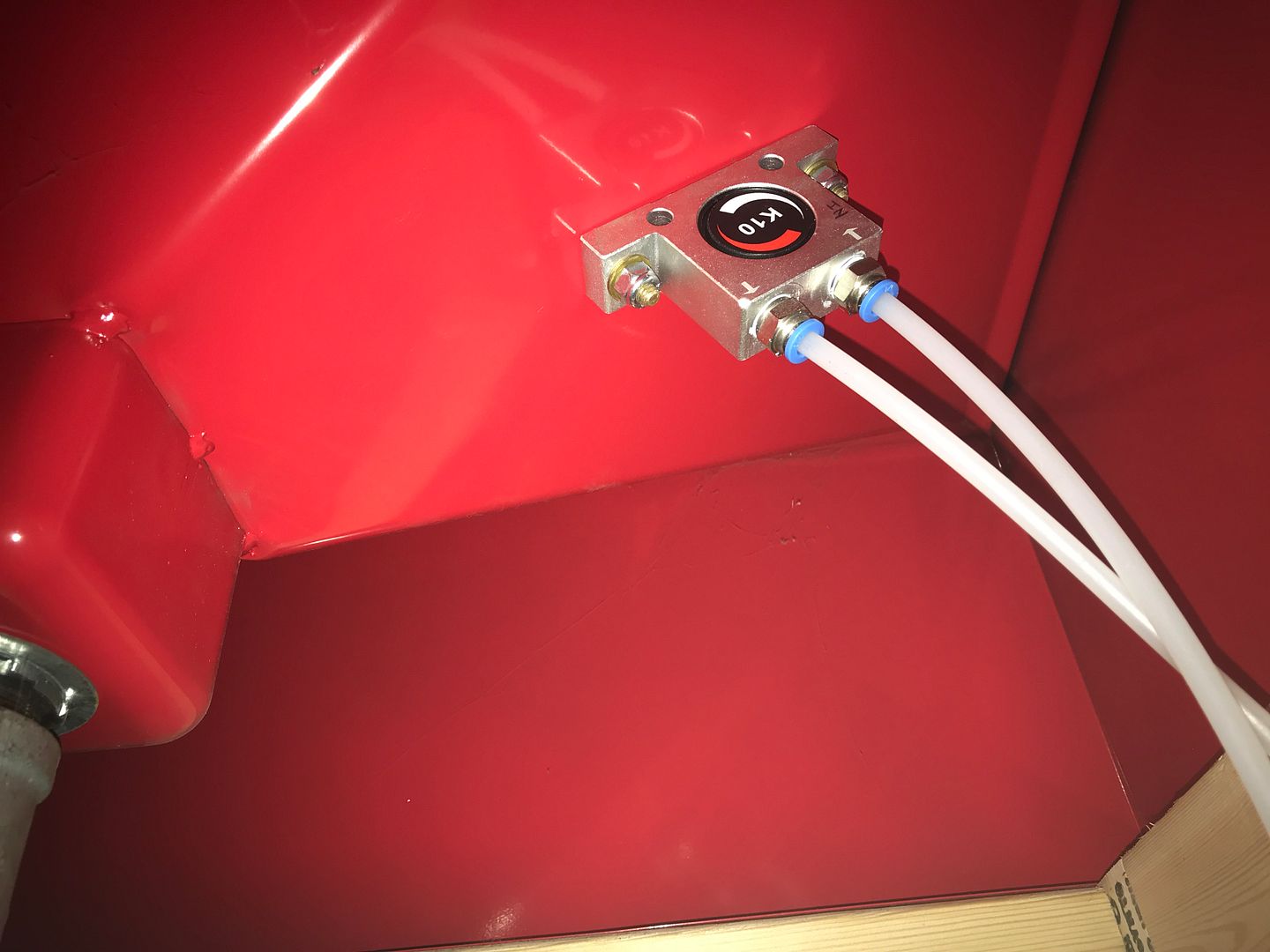

So what have you exactly done on the first two pictures?
Added a vibrator to vibrate the media back down. Ball valve so I can meter the air to the vibrator to adjust the speed.

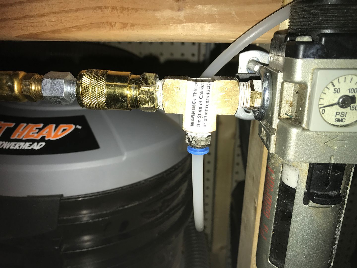

Swapped out the tank on the compressor The old one had a pinhole in it and I did not need it blowing up.
Tested the "new to me tank" by filling it with water, plugging it off and hooking up the pressure washer to it and cranked
it up to 200psi and let it sit a couple of days.
I cleaned up the tank and painted it with Rustoleum that I shot thru my HVLP gun.
Added a muffler and an auto drain, so it just whispers when it drains off and doesn't scare me to death!
