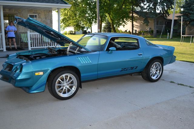

Well my car Is going in for a complete make over. The car is going in to be repainted after 27 years its do. The paint was starting to get wavy the primer must of shrunk after the years . So it time Total 100 % rust free and straight so a good base to work with. The Guy painting it did project Re-Peeled and Envious . With all the parts removed the car sits up like it 4 wheel drive. So Stay tuned

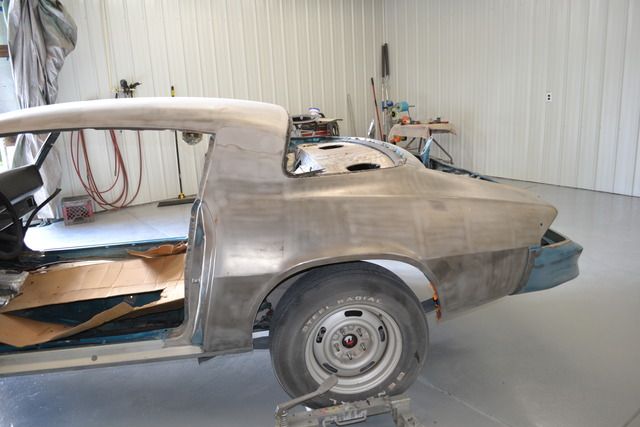

All stock color and decals . Their going to Soda blast it down to bare metal. Removing everything . Than fix all the gaps and factory@#$% ups Were going to spend a lot of time block sanding 140 to 160 hrs block sanding so its super straight. Than using PPG Paint. Once painted were using I think the 3M clear stone guard on the lower parts of the car from the decals below and the rear lower fender. New Glass , Engine compartment will be semi gloss black .Were not going to smooth the firewall It will have Anvil carbon inner fenders .Ring brothers hood hinges , All softseal rubber.
