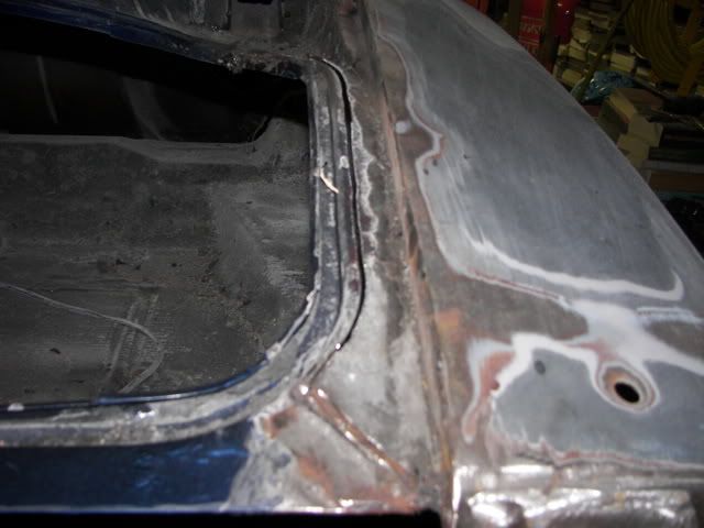

more...
this is more recent tear down of the car which began last year. I'm combining a 1978 camaro body with a 1973 front and rear plus a whole bunch of mods to suspension, interior, engine, and tranny. ill post more pics when i get to that point. why not just buy a 1970-73 you say? this is my father and i first and only project together and i will never get rid of it. plus it is always fun to do something "out the box";)
:bowtie: ~mike~
gutted interior and started smoothing firewall, patching floor:
removing 78 quarters and preping for new 70-73s.
70ish camaro
Michael Sanders
Apr 14, 2008
277
Covington, LA
even more...
surprise i found behind both the quarters:
you can see the new piece welded onto the bottom right. painted with rust preventative paint and ready for new full quarters:
i will post some more with both new quarters on tomarrow. looks crazy already! i love it.
