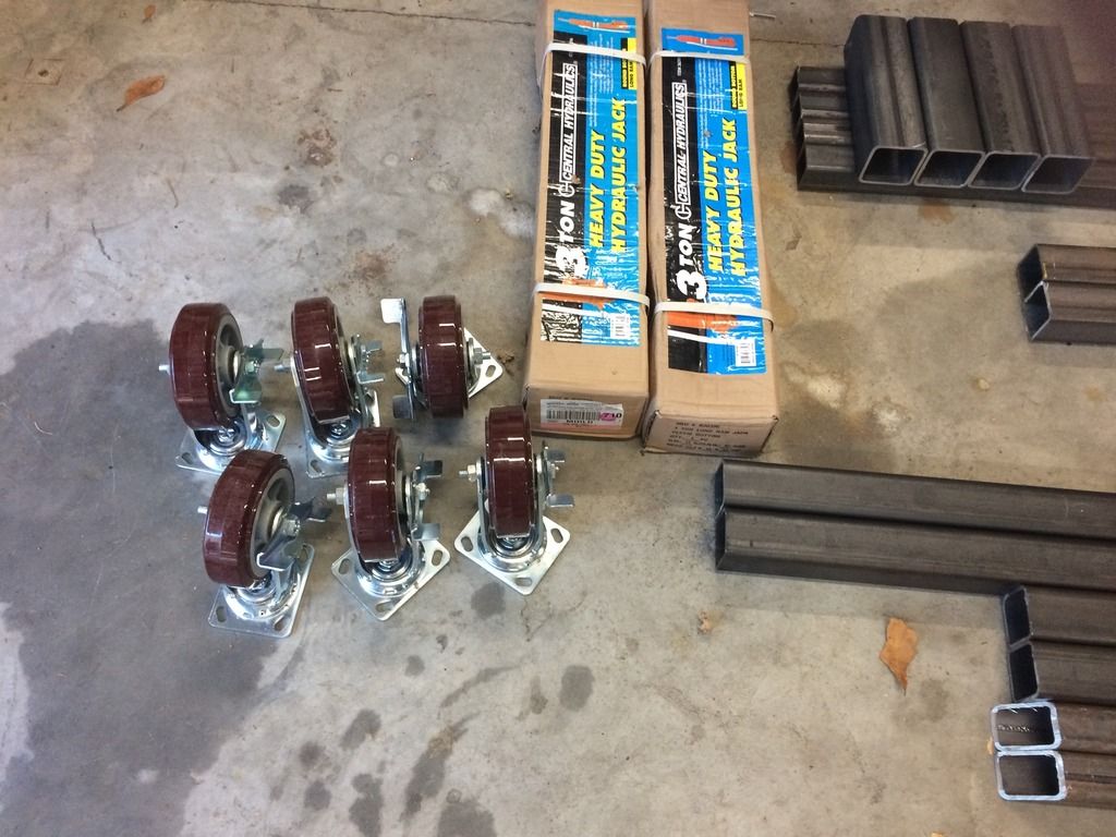

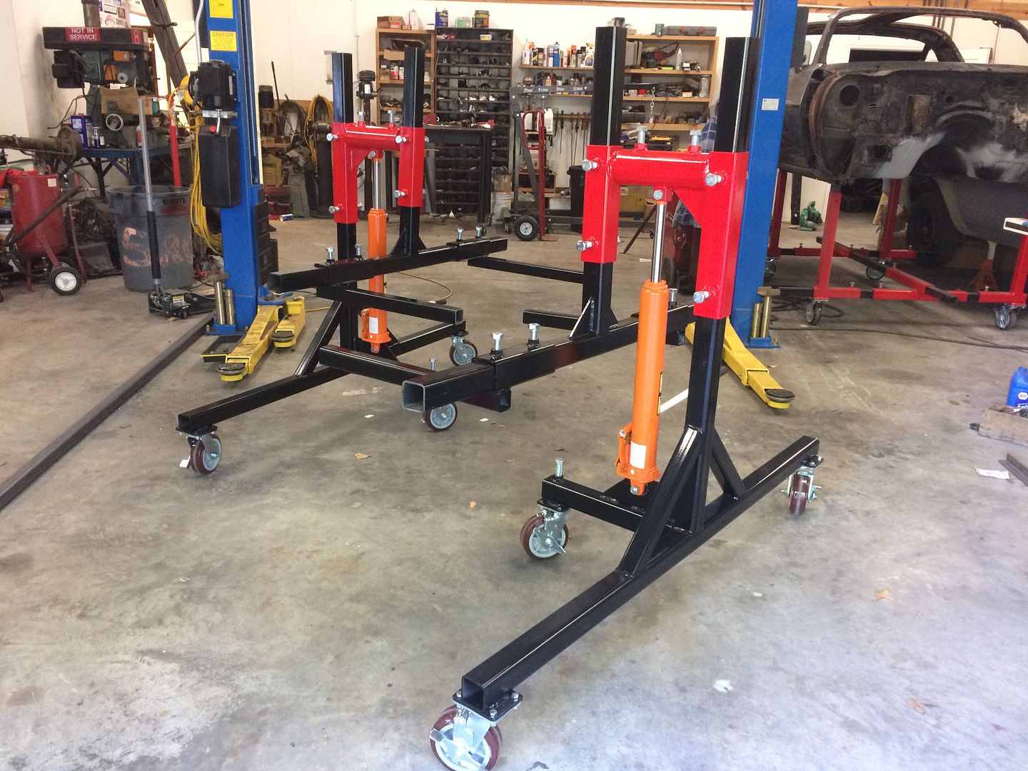

Hi everyone, I tossed around for months if I should just buy a cheap China rotisserie or build one myself. It came down to it would really easy to just hit send and in a couple of days a truck show up or go out and buy the matials to build one myself. I finally decided I should just build one and thought I'd share it here. I found what I feel is a really good set of plans searching the internet http://redwingsteelworksplans.com so here we begin.

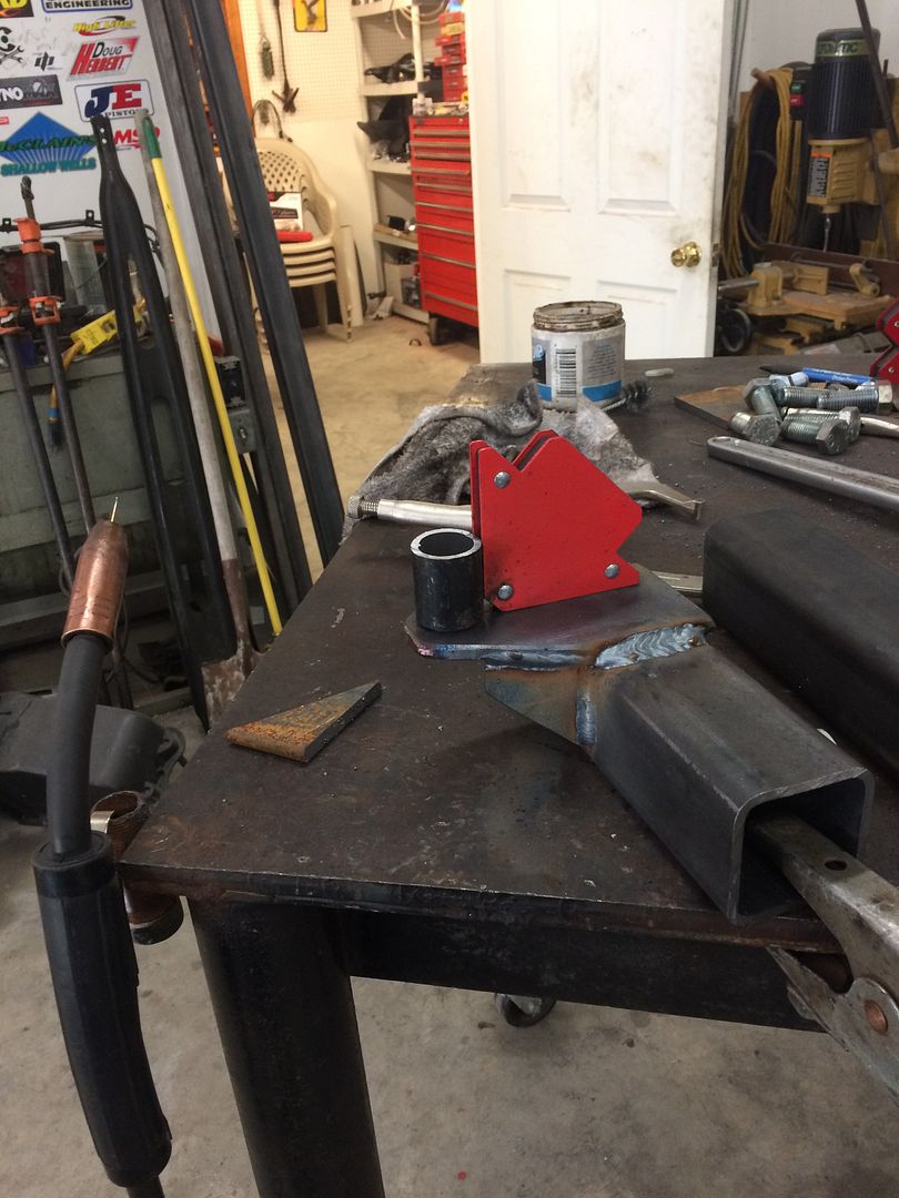

Day one cutting steel
I also picked up long arm jacks from the local Harbor Freight and caster over the internet
so this is my start

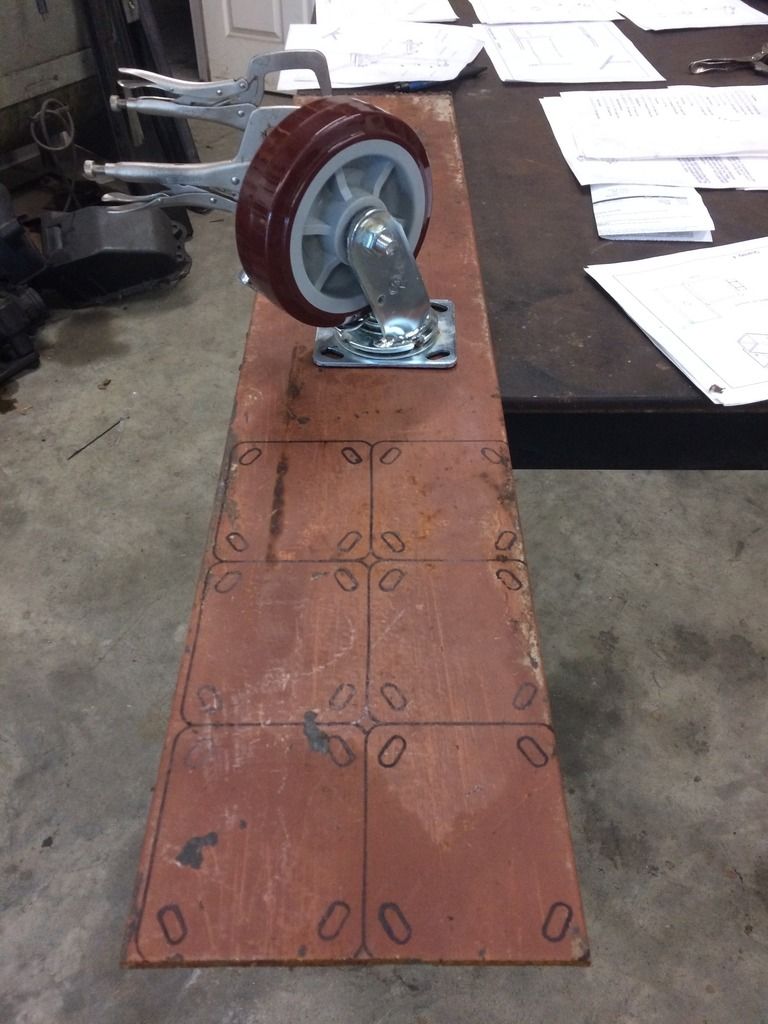

Ok day two started out making the small parts, first I laid out caster plates to be cut with porta band

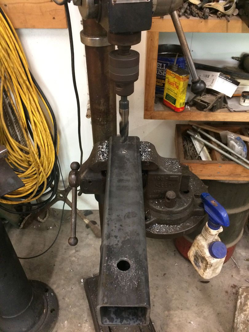

next it was time for some drilling, drill press is my friend LOL

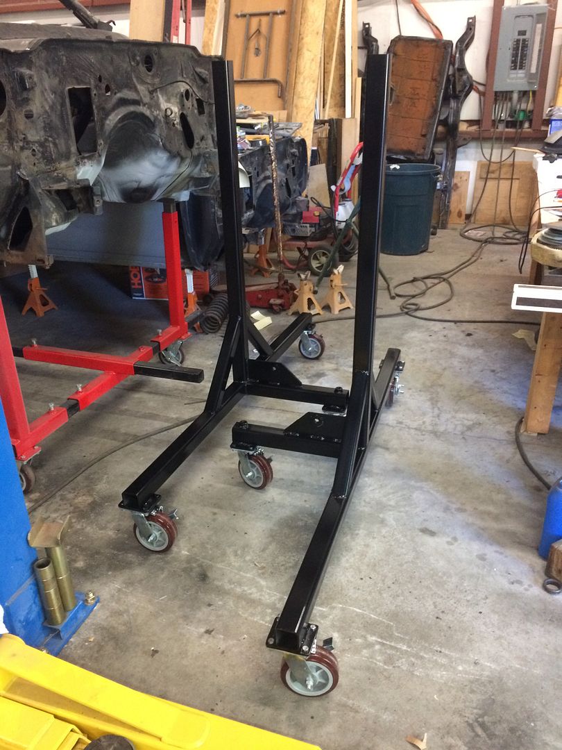

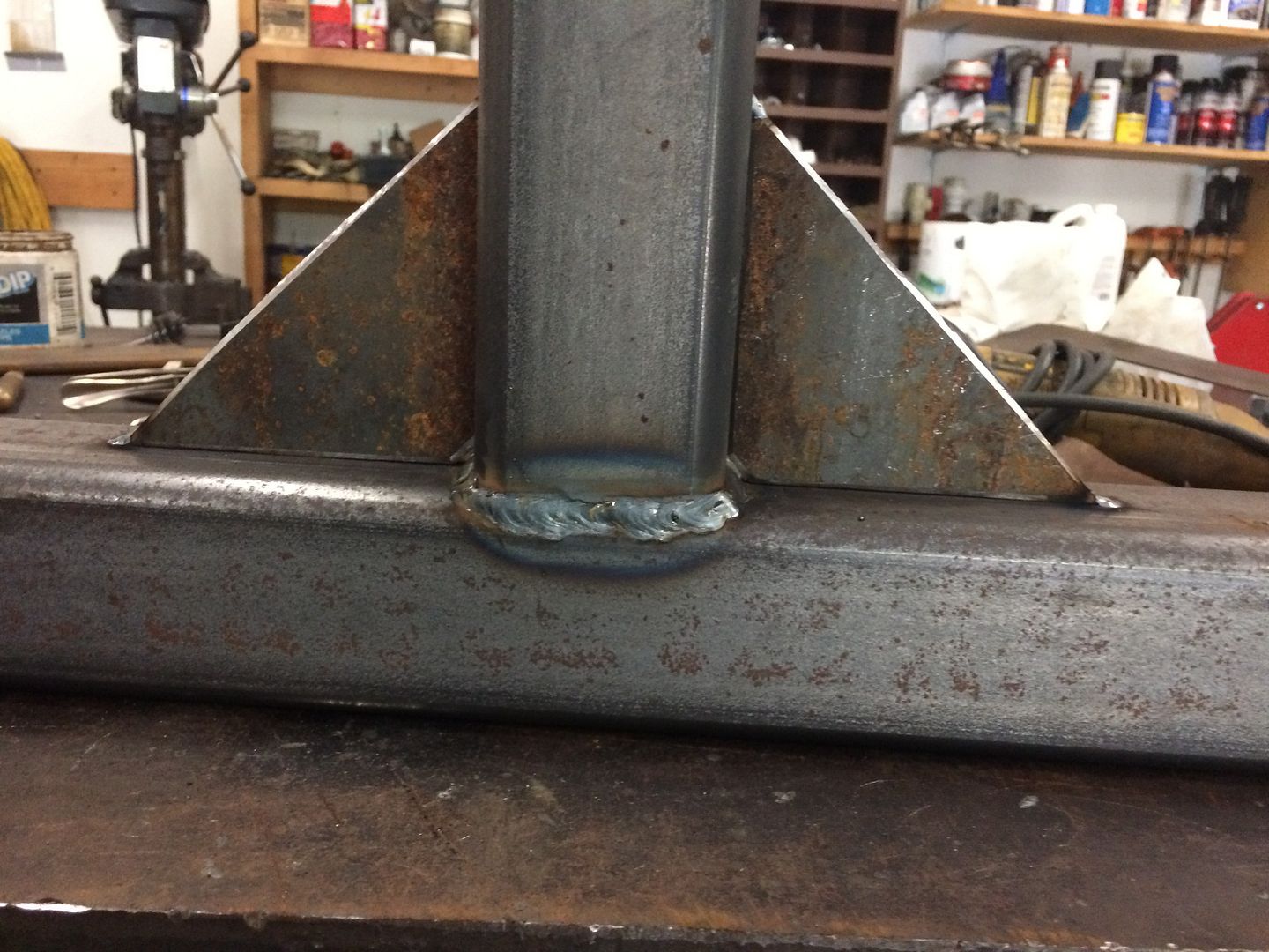

with these made it was time to get around to some welding, I started with my end frames

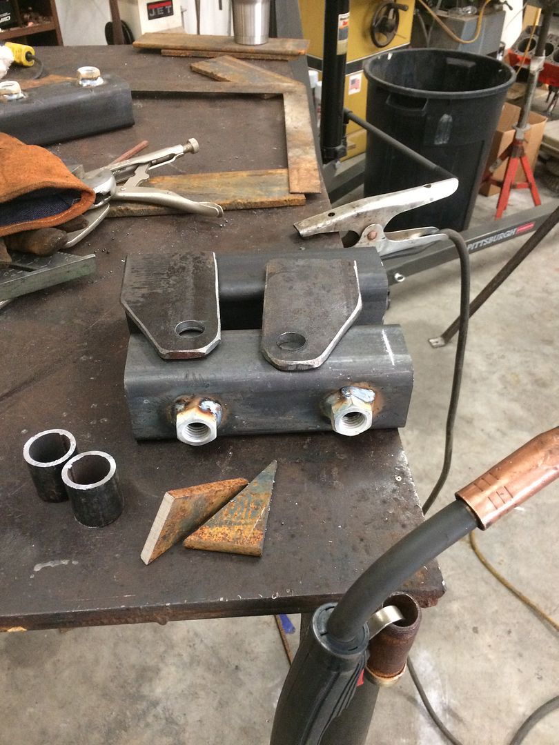

from there it was back to fabbing parts for pivot points, alot of drilling goes into building this

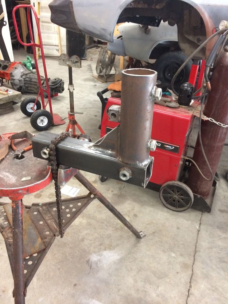

so to end day two I had the two pivot points made and the two end frames, I must be getting old as I was wore out
here is a pic of two end frames completed

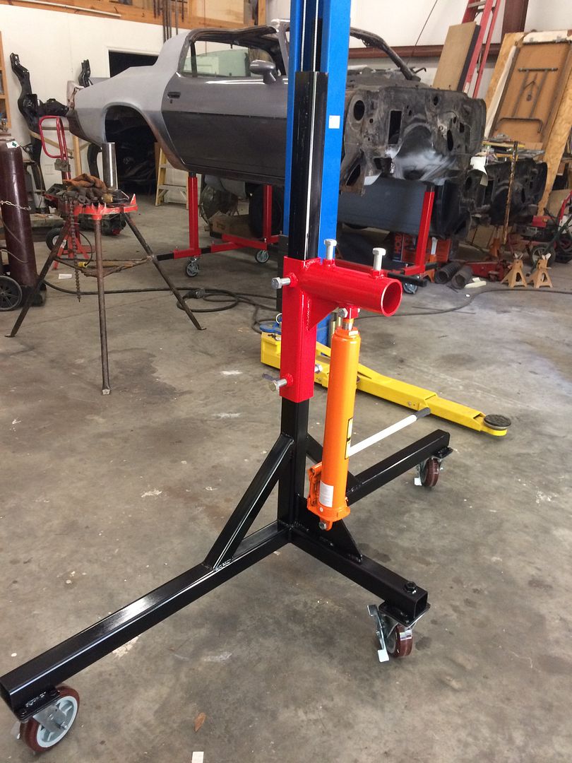

So now it was time to assemble the pivot arms, these call for a 3 pass weld
alittle paint and here you have it

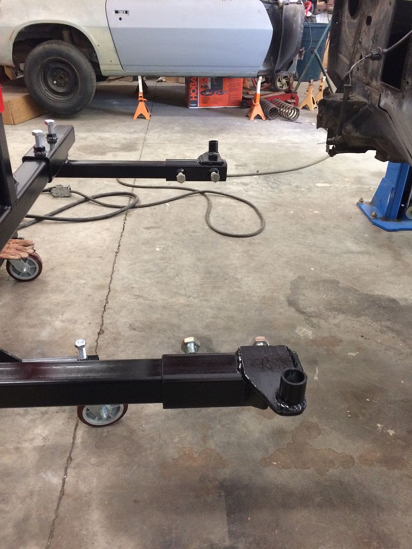

next came the hanger brackets
and to finish things off the body mounting arms
thats it for this weekend, hope to get my 79 Z28 on it next weekend

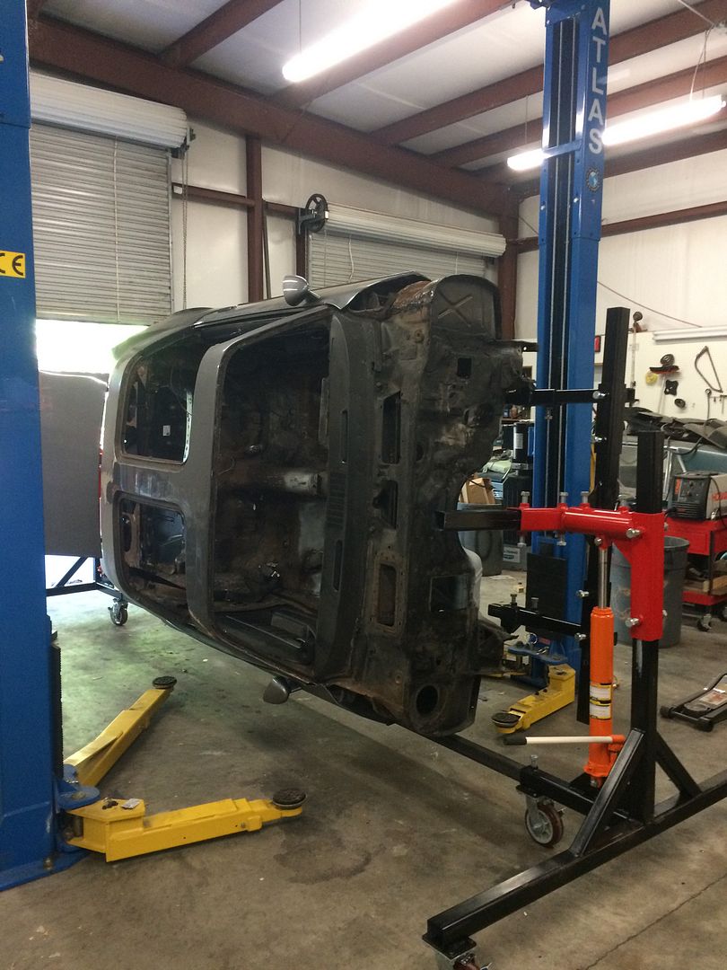

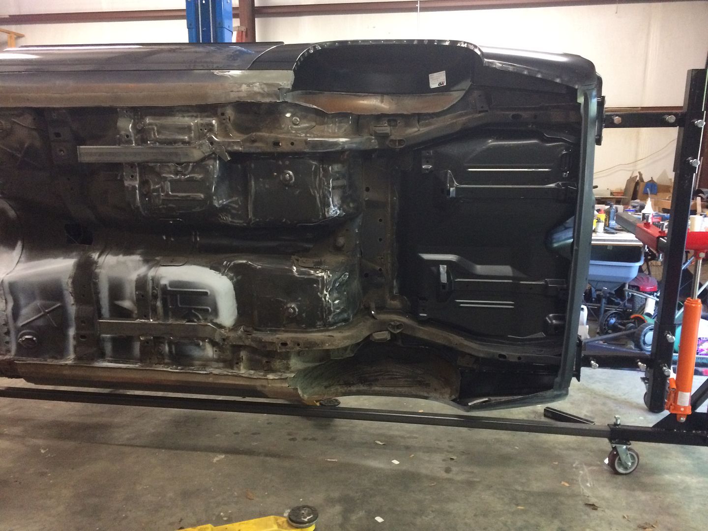

Ok finally got to make more progress, started today by fabbing up parts for body mounting brackets. These may seem to be over kill but I like them
the rear brackets are much more simple
And finally car mounted up
70lt1z28
Oct 3, 1999
5,084
Beavercreek, Ohio, USA
Beautiful job. Mind if I copy?
Nice thing about yours, I wouldn't be afraid to load it on a trailer and truck it across the country and not worry about it breaking halfway.
