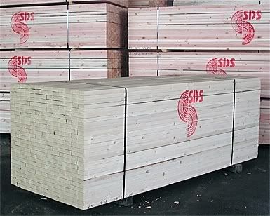

    I love this idea...I got it from 72CamaroSS so I took pics as I built a set for myself...My plan is to buy a lift when we buy a house but till then,this car is LOW...These get the car up to a good height and IMO are safer than Jack Stands at this height...Plus Jack Stands can sometimes get in the way...Also, our car will be in the air for a while and what if I need to do a brake job on the daily driver and need my Jack Stands...So here it is...
    You need to start with a stack of 2x4's...10 to be exact...I got the econo studs 96" I think...Just under 2 Bucks a piece...
