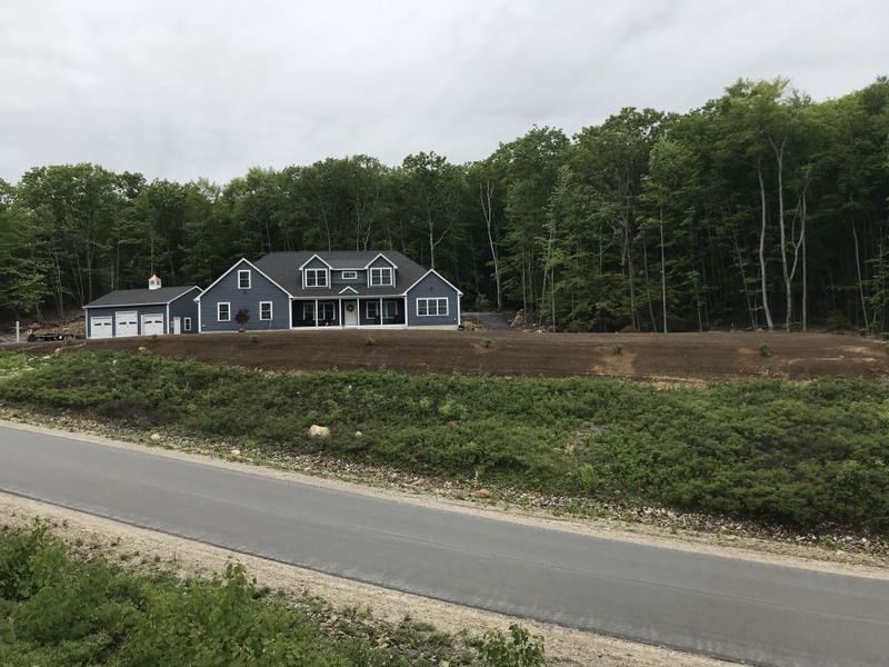

Sure does, I was looking at Morton Buildings when I decided to stick build mine since I was building a new house and wanted it to somewhat match. I am very happy that I did now, but the cost was significantly more than a pole barn or metal building.
This is what I ended up with. The garage is 36X32. It has trusses so and are not rated for weight so there is no usable attic. I saved cost there and I painted all the inside myself. It has heat and it's own 200A service.
