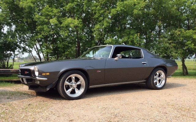

Either stock or period correct slots or five spokes imho
my setup:
Keystone Klassics 15x7 front 15x8 rear
235/60R15 front and 275/60R15 rears
rears are just flush and neither rub at lock or over large bumps and great rake!!!
