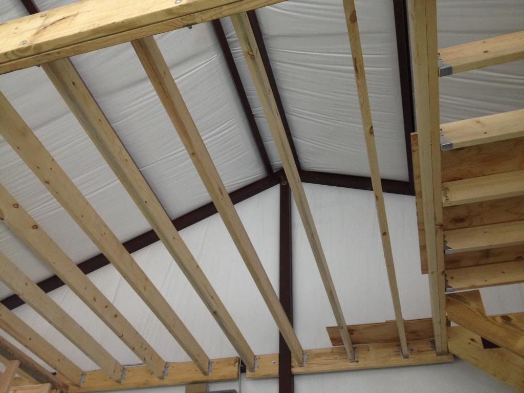

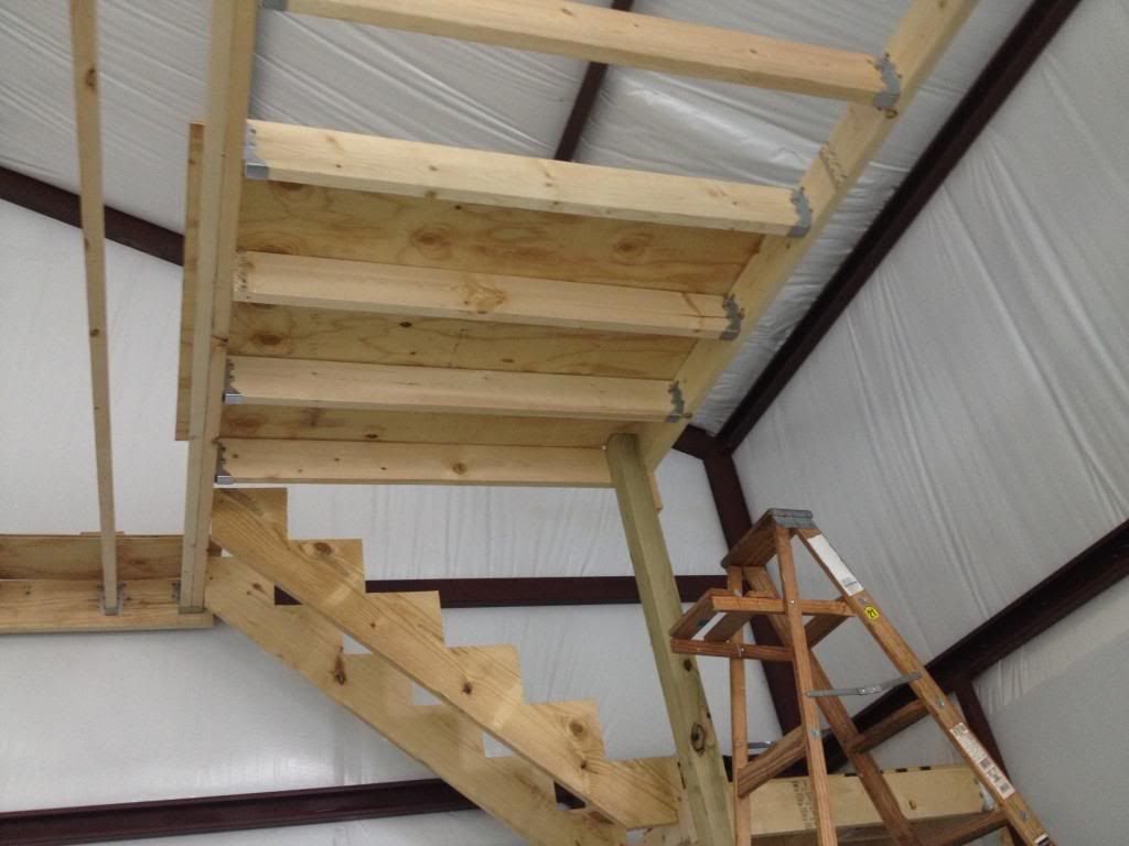

Started building the loft last weekend. Its 10X24 with the stairs in the rear corner.
Here is the landing for the stair case
I wanted to have the 24 ft span open underneath so I built my own beam. Its 2 2x12s with a piece of 3/16 steel plate in the middle.
The 2x6s holding up the beam are only temp. There is now a 3 inch steel post holding it.
