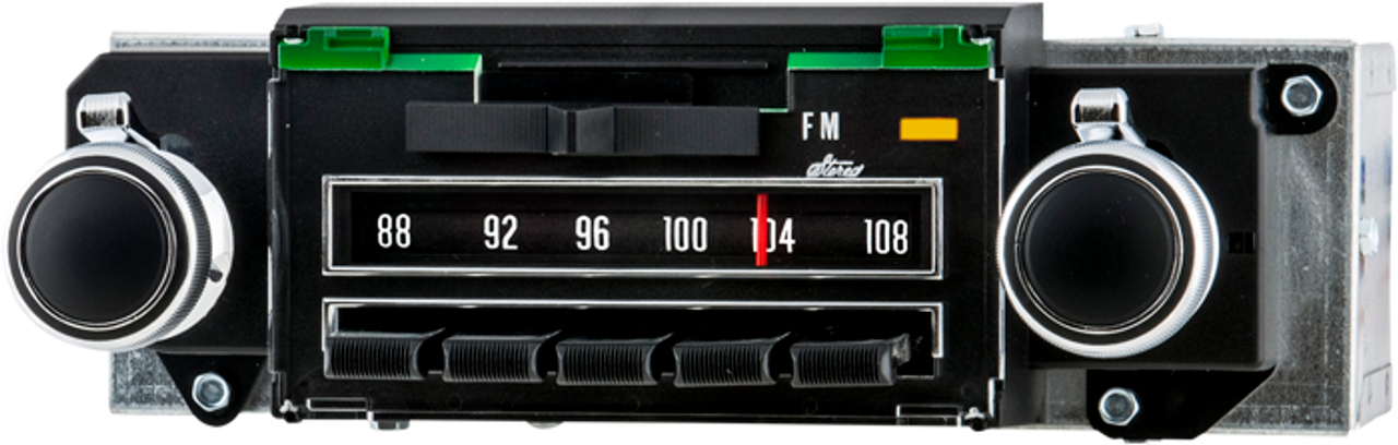

Is it cheaper to have an OE AM radio converted to AM/FM/USB/Bluetooth or to just pull the trigger and buy one of these?
I like the look of the stock radio, so buying an aftermarket radio is not an option for me.
Repro 1970 Camaro AM FM Stereo Radio with bluetooth

Since I didn’t already have a radio for my 71 I opted to buy one similar to the one you have pictured from an outfit in Florida which has the Bluetooth and has more power output than the factory radio. I’ve been pleased with it.

From my research, I have found it is about as expensive to have someone make this conversion to my OE AM radio as it is to buy the radio I showed above. That's NUTS!!!
