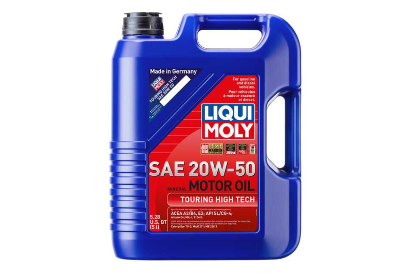

I was out at a track day today and got to chat with the Liquid Molly rep for a bit. In general I've never paid much attention to this brand, but not for any specific reason.
I asked about an oil for flat-tappet cams and he had a couple of recommendations.
This isn't an endorsement by me, but more me letting people know that a product exists that you don't see advertised.
The Touring High Tech SAE oil
This is a natural base oil designed for older cars. He says the ZDDP content isn't that high but they use another additive to achieve the goals of protecting flat tappet cams. He uses this in his own 455 Buick.
I tend to be more of a fan of Full Synthetics but this may be a good options at <$60 for 5 Liters, it's cost competitive with the Job Gibbs oils
The rep also mentioned
This is an additive that's supposed to serve the purpose of a ZDDP additive (and it part of the oil mentioned above). Most of you know I'm not a big fan of oil additives - I want the chemistry to be included in the oil formulation. But if you want to use an additive, this might be worth exploring

FWIW, i've ran my bone stock '79 350 on exactly that 'Touring High Tech' 20w50 for the last 6 years with NO additives.
Never had any problems, engine runs smooth, oil looks great, changing once a year before winter storage.
