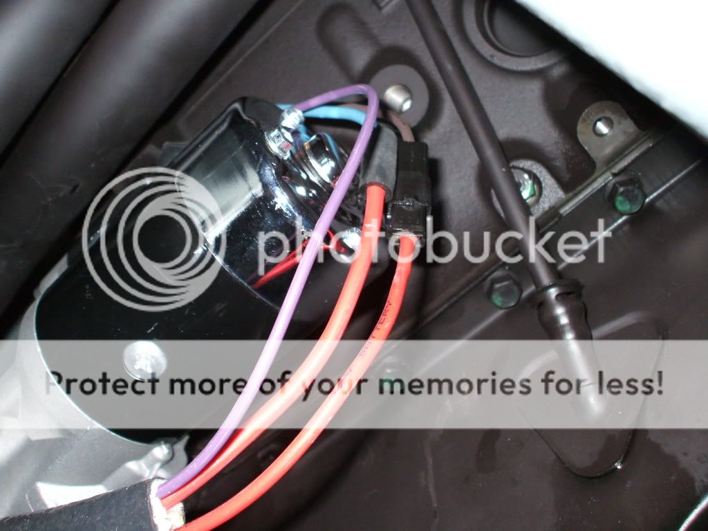

Here is a shot of the fusible links.(New AAW kit,aftermarket ht starter)

The answer to the problem was already mentioned above - If I'm not mistaken, you laid a wrench across something and shorted the car out. I did this a long time ago when I was jacking around with the alternator and didn't disconnect the battery. The heavy red wire hit the valve cover and I heard a "SNAP" and that was it.
The fuseable link(s) that go down to my starter had melted to protect the rest of the wiring. Replaced those and I was back in biz. You can see the fusable link in the above picture... in my car it's an orange wire that turns brown. Between the 2 is the link.
