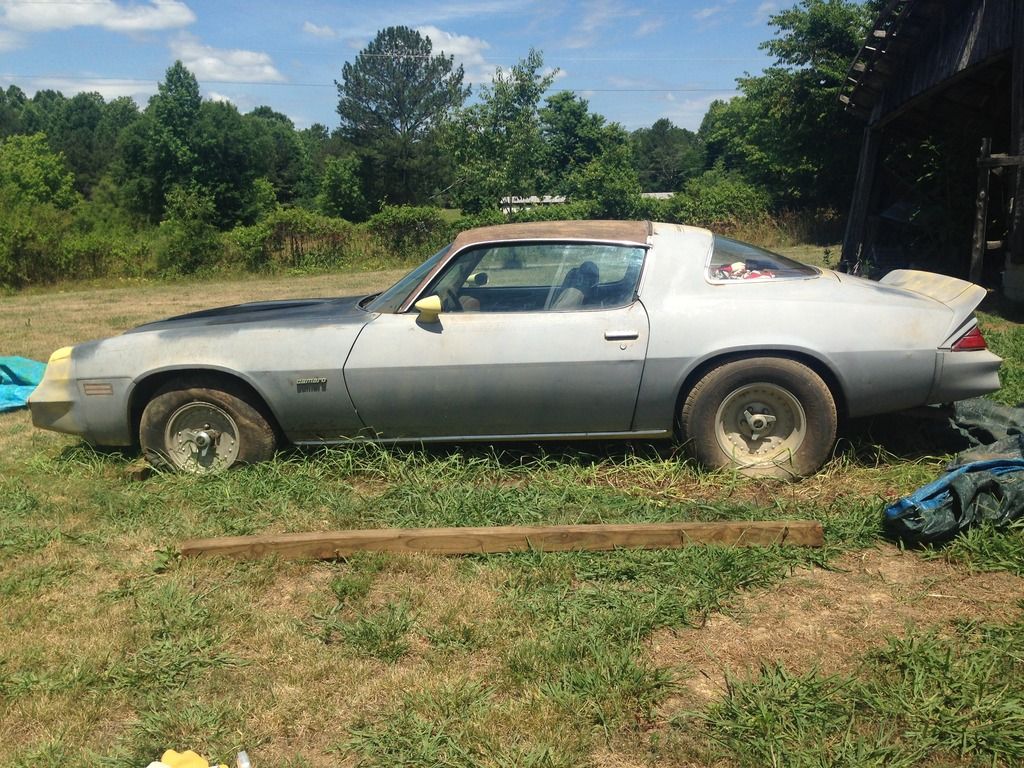

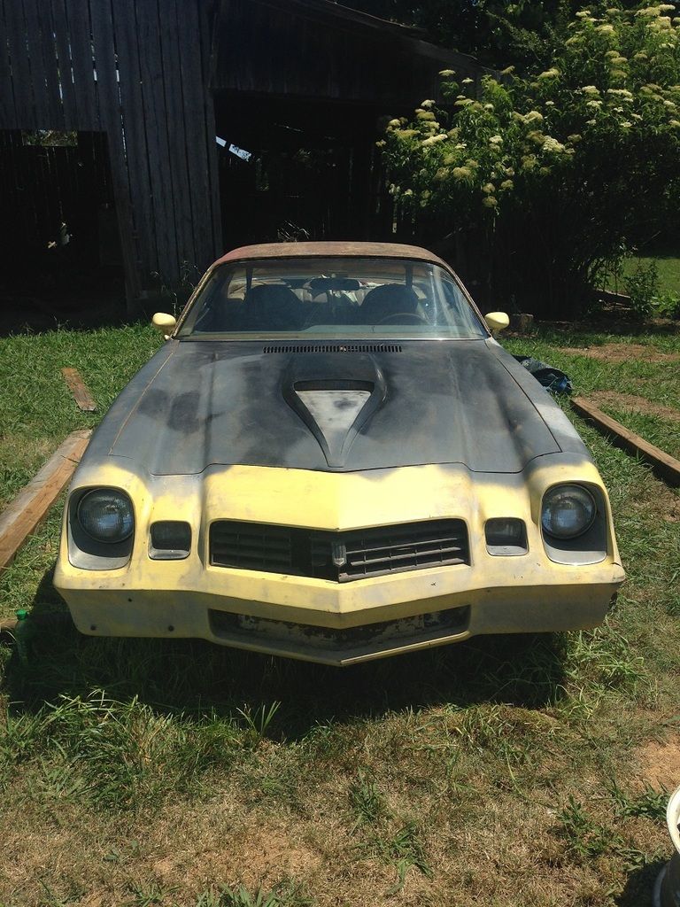

My name is Ricky. I recently got a 79 Camaro from my brother that used to be our dad's. Our dad died when he was 32, I was 12 and my brother was 10. My dad was a total gear head. He could build anything and fix anything that had a motor. Me on the other hand, I'm more of a body guy. But, I really wanna learn the mechanical know-how.
My brother held on to it for a long time (I'm assuming he was hoping to have a little boy and rebuild it together). He had 2 beautiful little girls and never got to doing anything with the car. So, it sat inside a barn for 17 years after my brother locked up the little 305 my uncles had put in the car, when they give the car to my brother when he turned 18, because the engine my dad had built (I heard was a 302 Chevy, never seen it though) that was in it scared them and they swapped it for a 2 barrel 305.
I'm really wanting to get this thing restored (not looking to make it all original, just a bad ass ride.)
I don't currently have an engine, not sure where I want to go. Although I really like the 400 SB, but I'm pretty much an idiot when it comes to mechanical stuff (besides the obvious easy fixes lol). It's got traction bars, 350 trans, not sure of the rear end.
Anyways, my story is all over the place. It's gonna take some time and money and little by little it'll get there. I'm not the smartest but I'm willing to really put in the work for it and I'm hoping that with the help of you all that I'll get this car looking and running like it should be.
I honestly just have no clue where I should start. Any advice would be so greatly appreciated.
Oh, before I forget, my brother lost the keys, any tips or advice on trunk/door locks and unlocking the steering wheel? Be best to just call a lock smith? If anyone needs more info or pictures of something just let me know. If it will help you, help me, then I will do it.
Thanks in advance for reading my story and/or any help. It's genuinely appreciated.
