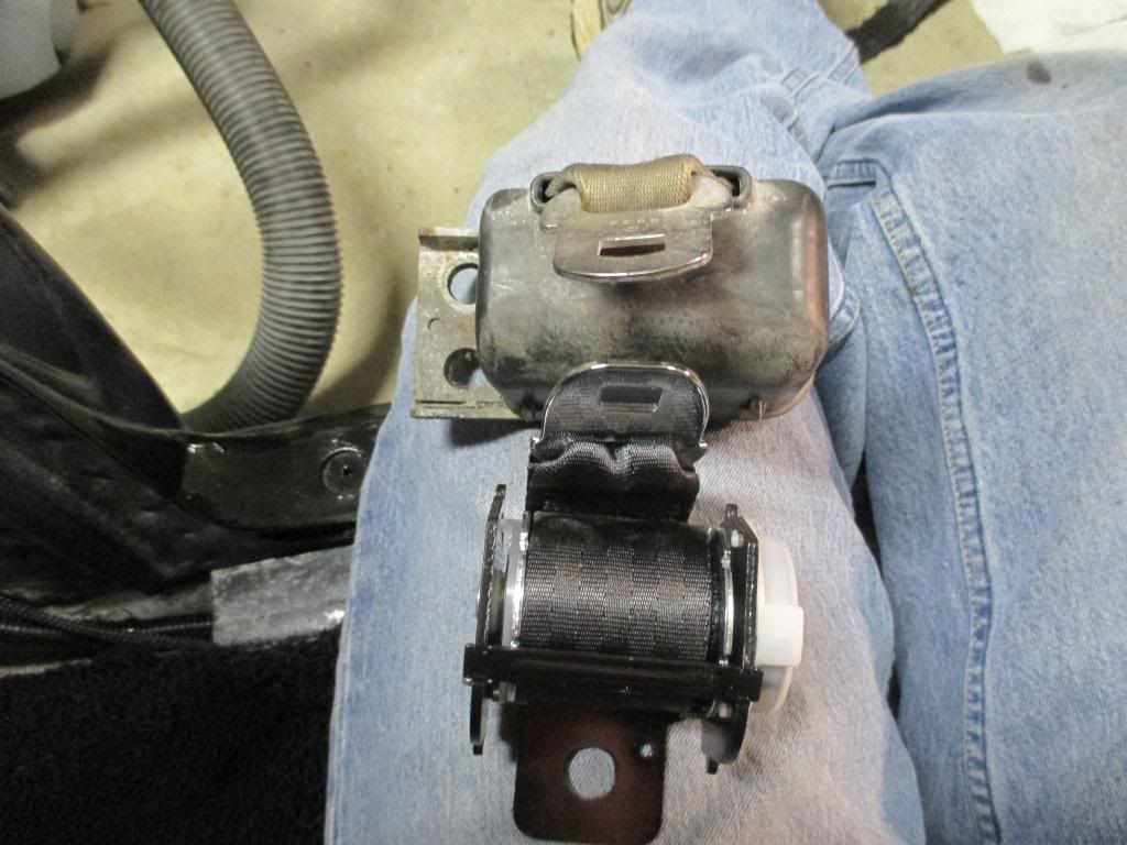

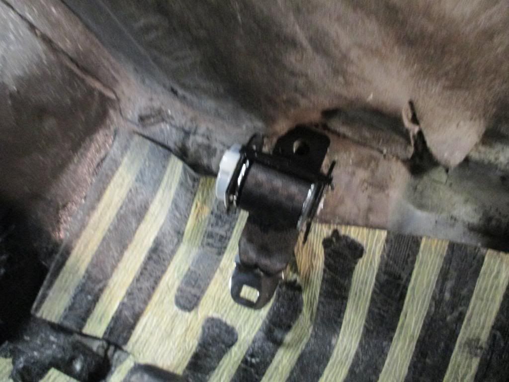

I ordered a full set of seat belts for my 77 Camaro from Seat Belt solutions. They supply a lot of the big companies. The rear retractors do not fit right. Its angled 90 degrees than the factory ones. I called the company and he said only the trans am/firebirds have rear mounted retractors like mine. He said they sell hundreds a year and never any complaints on the camaro fit. Does this sound right? He said I can send them back for a refund and credit towards rewebbing my factors ones but I'd rather just have new ones.

I had a 76 that I was looking at doing the same thing and noticed the difference
I had planned on taking a piece of 1/4 steel plate and fab something. If you look at it, all you need to do is make something that will screw down with the factory hole and then bolt your new retractor to the plate
Once it's all in place you wouldn't notice it.
You might even be able to take the base off your factory retractor and make something work with that

Im not a fabricator, But Ill try to figure something out. Im just glad Im not the only one with this problem. On the phone, they made it out like my car was just one of a kind, pieced together
