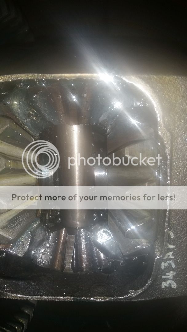

So, did some more investigating with my car... Turns out the person before me welded the diff...:( So, now I'm stuck trying to figure out what I want to do... Anyone have any suggestions? Can it be rebuilt? I assume the housing is still good will the spider gears just come out in one chunk or?
