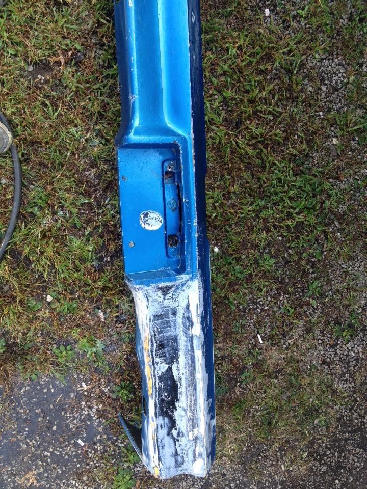

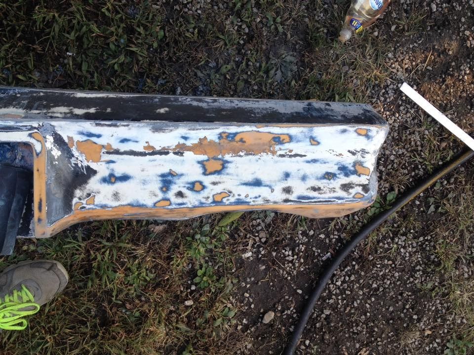

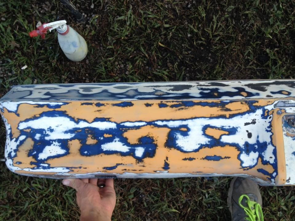

Switched gears some today. I decided to strip the paint off the old bumper I have for the car. Started out with chemical stripping...
After several rounds of chemical strip and scraping off the paint I decided to wet sand the driver side half with 220 grit.
Havnt sanded the passenger side yet.
If you notice the bottom of the bumper has some warp to it. Its not as bad as my original bumper but it still bugs me. Im thinking about putting a piece of flat stock aluminum behind the cover and riveting it to the cover to take out the warp.

How is the sanding going? I've got to do the same thing with mine and I'm reluctant to try chemical stripping. I got the SEM "bumper stripper" stuff for urethane but I'm still chicken.
Are you sanding by hand or with a tool? I was thinking my air jitterbug might work pretty well.
Blu-By-U 79Z
Feb 11, 2009
5,742
Kentucky
It sucks lol tried to soda blast it but it was to slow and would use a ton of media. So back to chemical stripping and hand sanding.
