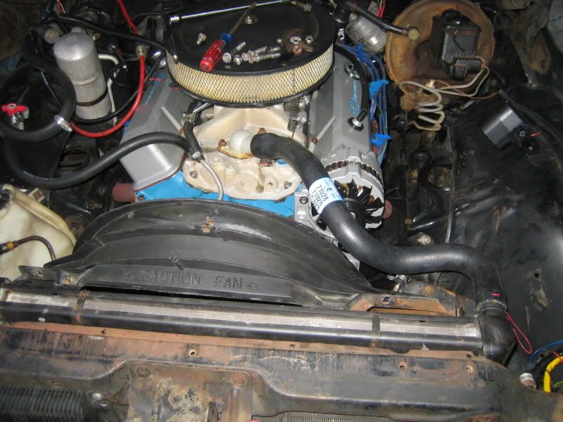

3SLO5 said:
Today after work bolted the ds serp bracket on with 1 bolt and put the rad and shroud back in for test fit of rad hoses, upper rad hose is a thirdgen tbi serpentine upper hose dayco part number(71028)and is a direct fit with stock thermostat housing. The hose will only work if your upper rad port on the radiator side is the smaller 80-81 radiator or is a replacement rad with the stepped outlet. The hose looks factory and is a perfect fit no bending of hose, manipulation or goofey ribbed universal jammey.

got a little more work done today after work, i pulled the headers out, the engine wiring harness, ac box and power steering pump and starter, the might as wells is starting and i decided that ill just take out 6 more bolts and pull the engine out and redo the whole front subframe and firewall, while im at it i might as well pull the suspension and redo the paint on that. some pics because everyone likes pics.
