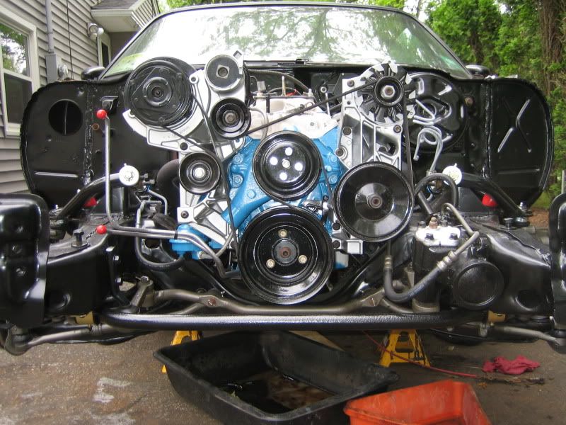

got some work done once again the headers are back on,serp setup is installed minus fan,heater box reinstalled after glass beading the box and painting it with sem landau black.1le swap is completed as well.
